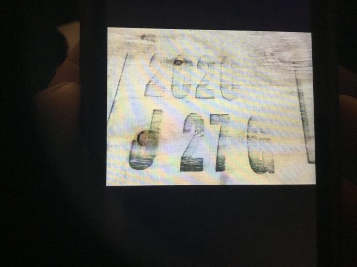

  4. MM1973 | Feb 09, 2020 08:59am | #5
    Not sure what these mean, see photos. There are three black lines along the side edge. This is Canadian by the way.
  5. jlyda | Feb 09, 2020 10:03am | #6
    I’m not familiar with Canadian stamp, sorry. All my work has been in the US and Scotland, so cannot speak on the Canadian grading. If the material was purchased through a building supply house I’m sure they sent the proper sheathing. Give them a call and they will probably know.
