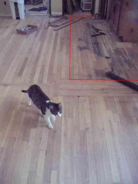

            Am trying to get the pictures loaded now so you can see the rest of the kitchen at this point.To recap: the entire floor (roughly 20' x 11 1/2' has been sanded, and looks great, imperfections and all, except the area of bad water damage which extends approximately 27" out front of the sink and 128" left to right.
            This area is all I need to deal with. It's already proving to be a pain to get the first board out. Frankly, I don't see sanding it as that big a job, IF shaving another 1/8" off won't cause other problems. I'm not aiming to do 4 x the work just to get the "rustic" look; I pointed out that I like it to clarify that I am not interested in replacing the whole thing to get it "perfect".
            On the other hand, I'm totally willing to work hard on it. I may be a girl, but I'm pretty strong (and stubborn).

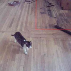

          4. Stuart | Mar 30, 2009 08:20pm | #8
            Re-sized for easier viewing...
            I'd replace the damaged section, plus it would give you an opportunity to replace that patched section in the foreground where the boards run 90 degrees to the rest of the floor.

  4. danski0224 | Mar 31, 2009 01:00am | #34
    I would remove the flooring in the area I marked with the red line and replace it.
    Just remove enough so it can't be seen under the cabinet if desired... but that may bite you in the future if further changes are made. If it was me, I would tear it all out under the cabinet.
    Use the existing patch of perpendicular boards as they are now- a break in the pattern. If you remove them, you will still be left with a straight line unless you tear up more and weave it in.
    There is still a single board to the left of the five or so running the wrong direction. Even if you remove the five (+/-), the amount of added work to weave in a "proper" patch won't change that one board... and it doesn't look like any of the five line up with it. If one or two of those patch boards are discolored, pull them out. If you like the rest of them, then leave 'em.
    Do not leave the stained area- it looks bad. You will regret it.
    I would suspect you will have to sand the new down to match the old. Maybe it can be planed down first to get close.
    You get to keep the other 75% of the floor as is.   :)

    2. user-51823 | Mar 31, 2009 05:18am | #37
      That's exactly the area I'm going to have to redo, in the red box. I am keeping the 90 degree patch, as well as the single 90 degree splice that marks the old doorway between original kit and breakfast nook. I know it can be feathered and if I preferred it, I'm obsessive enough to go to all the trouble to do it. Luckily I like it as is :-)
