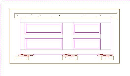

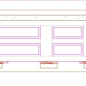

      Now, some Homeowners don't have a pile of long clamps so you can build a glueup table. Take a sheet of plywood and lay it across the sawhorses. Lay a sheet of plastic to it so your dorr doesn't stick to it.
      Screw some blocks to it a little farther apart than shown in the diagram, and cut yourself some shims to drive in to push the door joints together..
