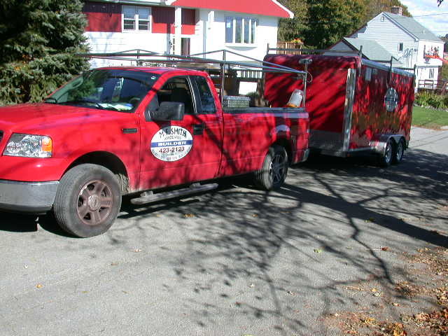

      bobby.. we have a 14' dual axle CarMate with 4-wheel brakes
      it was  $4100 in  '02
      i pull with an F150 .. no sweat...
       if i were doing it again , i'd get a wedge nose so i could use that wasted space over the tongue
      if i were getting a 12'.. i'd still get a wedge nose, but maybe a single axle
      also.. i think the ramp doors are over rated...  they take up a lot of area when they're down... if you need a ramp you can always get a separate one
      i see more damaged ramp doors than i do barn doors..
      find out what factory extras you can buy....  like the side door, the  roof racks, plug-in lighting systems, leveling jacks, etc.... hard to beat the factory add-on priceMike Smith Rhode Island : Design / Build / Repair / Restore

  11. MikeSmith | Jul 05, 2008 03:53am | #37
    got some nice details...
     i like the table saw  & miter saw sitting on the  shelves  especially
    here's ours....
    Edited 7/4/2008 8:55 pm ET by MikeSmith
