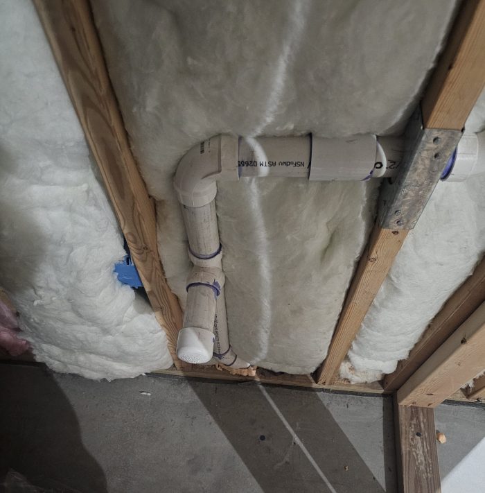

From concrete floor to centerline of drain is 19-1/2″.  Going with either a 18″ or 24″ vanity, most likely 18″ since it’s a small powder room.  As you can see in the photo there is a 1 gang electrical box to the left of drain stub and the outlet is on opposite wall. Not much room to fasten a PEX stub out bracket and appollo Bend support.
What other PEX stubout mounting locations do I have to stay within code?  From what I found online the PEX stubouts are spaced 4″ from drain center on each side and  21″ high. Any suggestions on brackets and mounting would be appreciated.

    Put them both to the right of the drain 4" apart with hot to the left of the cold. The hot
    can be 3" from drain.
    1. ts2021 | Dec 11, 2024 10:30am | #2
      That will work. It's difficult finding resources on plumbing code online when you have issues like this. Additionally, when you don't do this type of work everyday. Thanks
