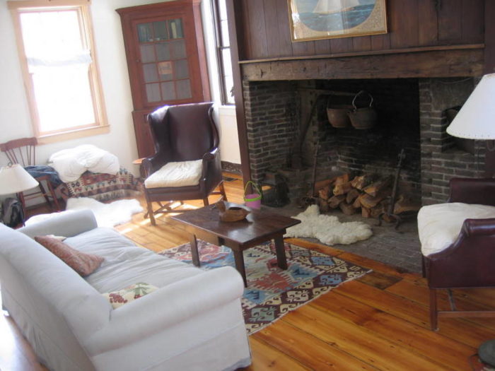

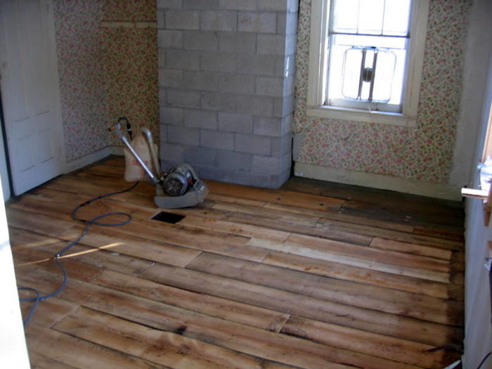

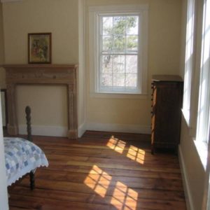

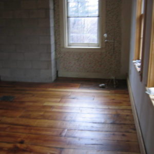

Very nice, indeed. What finish did you use on the floor?
Do some of the floorboards end midspan between joists? How thick are the boards? I am assuming no subfloor, correct?
In my 1830s house, the chestnut floorboards that end midspan are cut at a matched 45-degree angle. They are tongue-in-groove and about an inch and a quarter thick. So plenty of support.

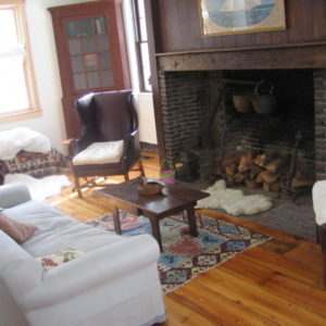

Is that fireplace original to the house? What part of the country?
I haven't gone back to your previous threads yet, so forgive my lack or recollection.
Great work!
Allen
The House is in NW Mass.
I used polyurethane as a finish on the floors
the boards are about 3/4" thick.
In places there is a sub floor of 1/4" very rough sawn planks
Some of the flooring is T&G some not.
The floors are pine
as far as I know the fireplace is original, however there was work done in the 40's
in that room and the hearth may have been modified at that time.
Here is a picture of the Fireplace with the brick above the box exposed
thanks for you interest.
