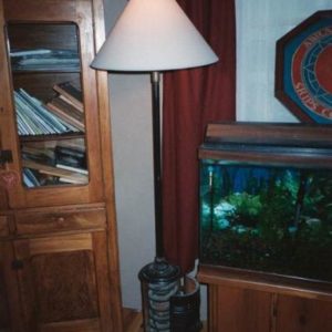

Here is an early tankless water heater that I turned into a floor lamp.

    I have seen one similar that was described as a barn heater. To provide hot water in a out building such as a barn or stable.

    Well, I've seen electric meters turned into lamps, but that is the first water heater lamp I've seen.
    hmm.. actually works pretty well, but I'm guessing its a heavy lamp.

      Yep. It's heavy...a "heavy light" get it...a heavy light. Ha Ha!At least the center of gravity is low. It does not tip easily...and as heavy as it is, that is a good thing. <g>

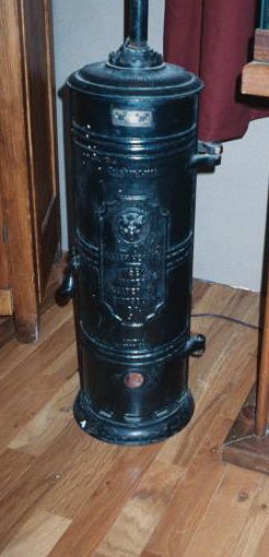

        My wife was looking over my shoulders and asked me " what is that?" " How did they heat it?" That is my question too and where did you find that?

          Natural gas. Here is a close up of the burner and coils.I found it in an architectural salvage yard in Denver, about twelve years ago,

            I can't imagine a bunch of these things anywhere, but I do have a friend who plans to copy the design to make a water heater for an outdoor shower. He will build his with some flexible copper, a gas burner, and some sheet metal.

            I used to live in a house that used two of those for heat. No pumps, just convection.

            Cast in the door, in raised lettering the heater reads: LioN
            WATER HEATER
            No. 1 Lion E-11
            Pittsburg
            Water Heater Co.Pat Oct 7, 1907

      People can't believe it when I tell them I turned a hot water heater into a lamp.They have visions of a big white 40 gallon drum with a lampshade...so my lamp does start a few conversations.

    What you have there is what was called a "side-arm water heater".  Yours looks just like the one we had in our cabin at Lake Tahoe.
    It would usually have been installed in the kitchen, mounted next to a 20 gallon galvanized storage tank.  It was piped in a loop with the bottom and top of the tank so that by convection the tank filled with hot water.  The gas burner was lit by a match and you had to periodically feel the side of the tank to know when the water was hot enough.  Primitive, maybe, but a big improvement over filling a washtub with hot water from the stove.

      Side-arm water heater...interesting, I had not heard that.Thank you for the info.
