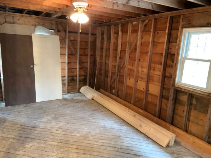

The biggest things I’m struggling with is exterior wall assembly. Initially I was planning for closed cell spray foam 3”. A new wrb on exterior, then exterior insulation and a vented rain screen. Likely with a cement board style horizontal siding. It has come to my attention that exterior insulation with cc spray foam is a no no because it can’t dry inward due to the spray foam. What are people suggestions? I’d prefer not to lose more room on the interior otherwise flash and batt would work well I think. Also, am I better with peel and stick wrb or not? I’m concerned with the peel and stick sticking to the old planks with so many seams. It would provide a good air barrier though. What are your thoughts on header hangers to save on wood around windows and add more insulation?

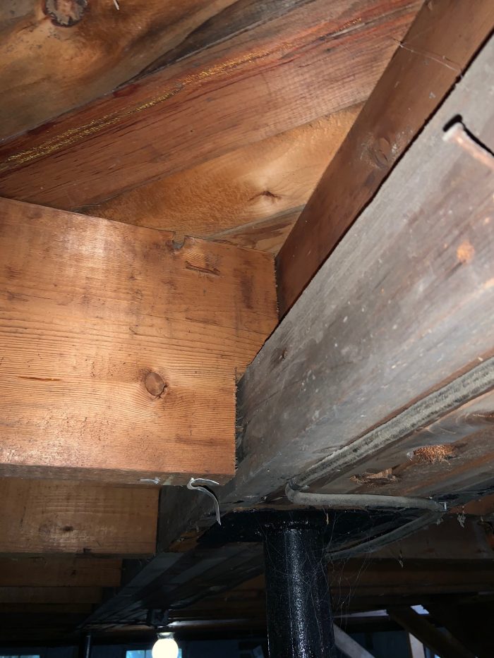

Second biggest problem is leveling the main floor. It varies up to 1 1/4”. The 2×10 joists are attached to the beam with a square cut out and sitting on 2×4. It seems as though they are sagging at the attachment point. The only thing I can come up with is to detach each joist, sister a small piece and reattach it to the beam with a double joist hanger. Thoughts? If I go this route how long would the sistered pieces need to be? There are a few spots on the subfloor to patch and I was thinking about attaching new subfloor sheathing over the existing after the patches are in. Do you think that’s a good idea? If so should I screw to the old subfloor or to the joists below. The intention is to have engineered hardwood flooring.

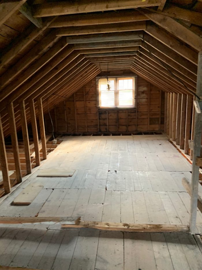

Next, the sloped ceilings on the 2nd floor. I intend to strap an extra 2” on the existing 2×4 giving a 6” cavity for cc spray foam. The roof sheathing is 12” wide 3/4“ thick planks. Is there anything to watch out for or is there a better way to insulate? Where the slope meets the outer walls it overhangs. Is it better to spray the overhang and soffit or put up a backer board flush to the sheathing and essentially extend the wall to the sloped ceiling and then spray foam? Any other ideas?
