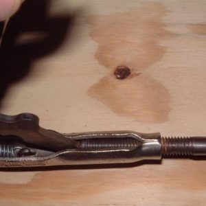

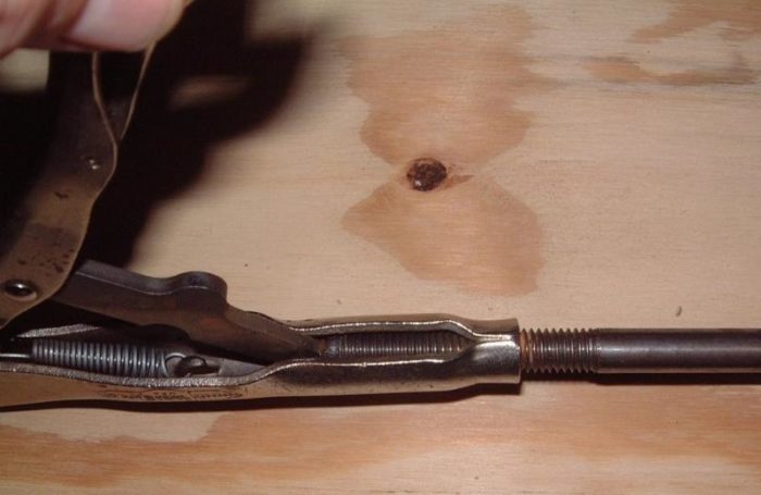

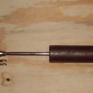

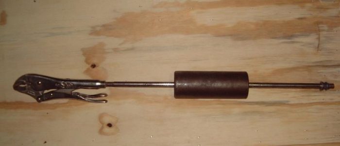

            do the same with Vise Grips.  Remove the adjuster screw and replace with a smooth rod threaded to match (or close enough) the adjuster screw.  Install a weight and stop nuts and you got a Vice Grip slide hammer. I'll send you a pic if you need it.

            You replace the screw with the rod that's threaded (I'm tempted to say threaded rod but all-thread won't work). I got some pics for you.
            First started using these when I worked aviation.  The set in the pics is ~20 years aold and still taking a beating (unitentional pun) .  Great for stuck bolts, pins, nails in tight locations, and pulling just about anything you can get a grip on.    The one I made is on the large side, but I saw them made on as small as the 4" vice grips.

          7. john7g | Oct 18, 2008 12:02am | #18
            1 more thing, the thread pitch of the adj screw is almost standard but not (at least that's the way it was on the one in the pics).  I matched it as close as I could with a NC die and haven't had any problems.  Good grade of steel in the rod might've helped too.
