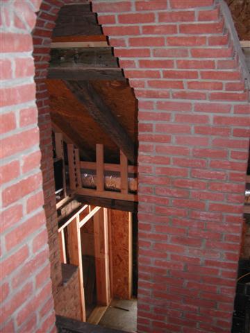

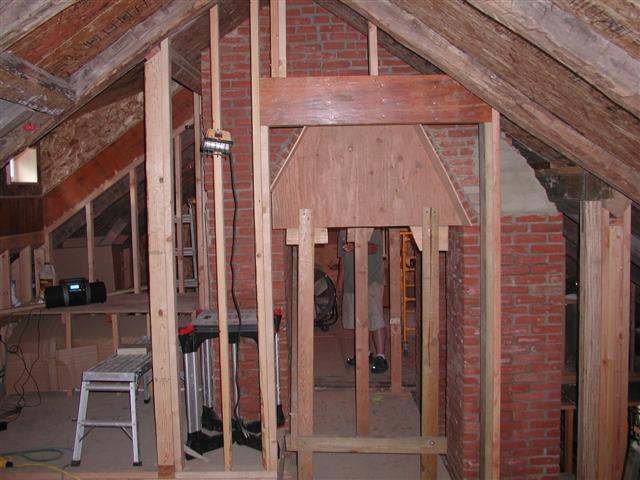

Thought some of you guys might find this interesting. It’s a job I just finished. The first time I went down to price it I was shown a drawing of 3 seperate chimneys coming out of the roof , for 3 fireplaces. But they were all coming out of the roof right next to each other. Looked like crap, and talk about a flashing nightmare!
I asked the architect if he could come up with something better, and this was it.

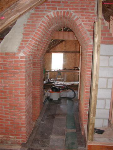

It’s an old timber frame Cape house. As you come in the front door, you head up a staircase going to the 2nd floor. You walk under a brick arch made from 2 chimneys connecting to each other. When you get to the 2nd floor, you enter a hallway left to right. The 3rd chimney rolls forward to meet the other 2 chimneys where they merge to become one through the roof.

Excellent work. I like the way you corbelled the brick.

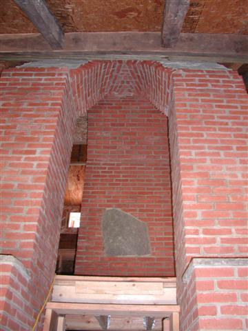

Very impressive, nice work! What's that dark patch that looks like a piece of bluestone in this pic?

Thanks for your comments. I had fun doing this one........but it was a mind bender at times. Trying to keep proper head clearance and make room for the flues!The stone built into in the chimney is a piece that came with the house. It is a schist type stone and it has "DEC" carved in it, and possibly an "08". This house was moved to CT, originally from Mass. The woman who owns the house wanted to put the stone in the chimney somewhere. Rod
