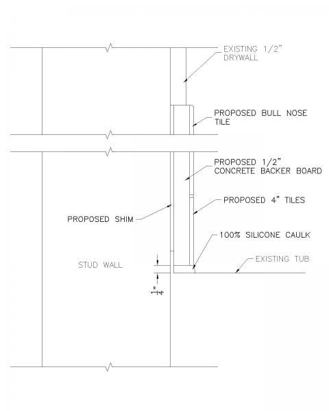

What is the best way to transition from the concrete backer board to the existing ½â€ drywall? Do I install the bull nose tile and then cut the concrete backer board flush with the top of the bull nose tile? Not quite sure how to do this. (see section)

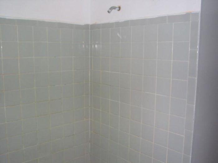

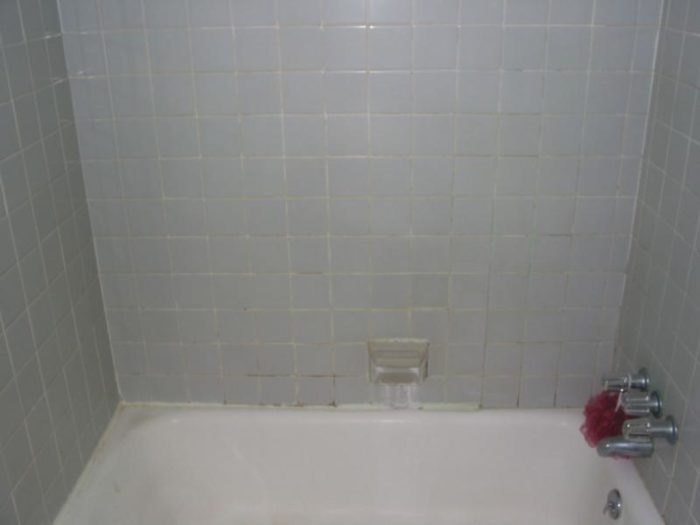

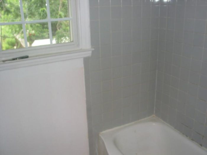

(see pics). This is what the bathroom looked like before I took the old tile down. As you can see the tile runs across the back of the tub right to the window frame. At the front of the tub the tile runs from the corner all the way across the tub to the corner of the next wall. Is this the correct way to tile? I always thought it looks kind of weird. What is standard practice when tiling a tub?

2-Tile just past the joint between the backer and drywall. (Do yourself a favor and tile it all the way up to the ceiling.)
3-Yes, what you had is a very common way to tile a tub area. You can do it anyway you want it is your house.

a) I have never shimmed a wall so that the CBU overlaped the tub/ shower basin lip.
b) The CBU always stops 1/4" above the tub/ shower basin lip.
c) The thickness of the CBU insures that its face is within the tub/ shower basin area.
d) Tile runs down to, -1/16th, the tub/ shower basin. Yes, it hangs below CBU. This is proper.
e) 1/16" gap is caulked with a rubberized silicone - clean-up with thinner only.
f) Tile to ceiling.
g) If you don't want to tile to ceiling, top row of tile should cover CBU/ GWB seam.

The window was just framed too close to the tub. Pretty hard to end the tile in a classy manner under that condition.
I run the CBU down over the lip of the tub if I can. Shimming will allow that. Then I caulk the CBU/tub lip with silicone. Then tile over. Then caulk the tile/tub junction with silicone.
The "back-caulking" I feel adds an extra measure of safety against water infiltration, and it's cheap and easy. Doesn't have to look nice, just get a good seal.
