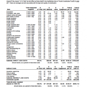

The 2019 National Construction Estimator gives the average cost of a good quality house at $125 / sq ft. Of that direct costs are about $100. Aprox. 1/2 is labor. So you've got about $50 / sq ft in materials. This should be adjusted for location somewhat, but mostly location will affect the labor costs. If you cut quality of materials by 20% and pay absolutely nothing for labor and incur no indirect costs, you are still looking at $40 / sq ft for materials.
There are three factors that affect housing cost. Complexity, quality and size. Assuming you cut the first two to a minimum the only way to cut costs further is to make it smaller.
In short there is probably no way to built for $30 / sq ft.

THANKS!! For that info that's great to know. Even $40 is great when architects are telling me $150 psf at the minimum.
In this county, new average quality tract housing, "brick" houses, go for 100-110 psf that includes land and garage etc. I also happen to know that the biggest City in the county charges developers millions in "impact" fees that the developers have to recoup.

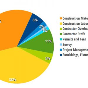

Labor is also very high in Dallas. I'm pretty sure it's closer to 70% than it is to 50%, just by looking at some HVAC or framing quotes I have received in the past.

Architect 30k, bank closing costs 20k, general contractor 50k, you get the idea.
