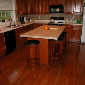

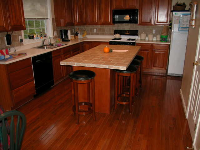

          JeffBuck | Feb 14, 2004 06:39am | #15
          the 5/16th bruce isn't a composite ...
          it's real wood ... solid.
               Artistry in Carpentry
            JeffBuck | Feb 14, 2004 06:40am | #16
            still don't think ya could live with it?

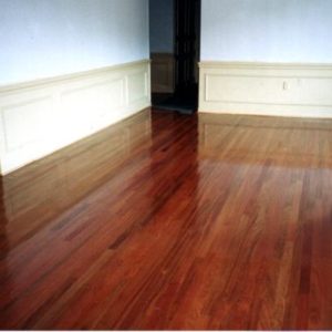

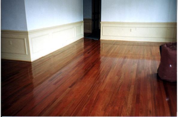

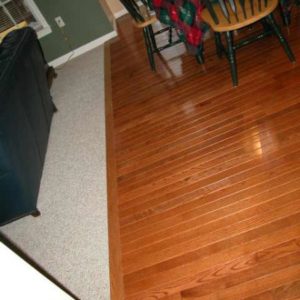

            JeffBuck | Feb 15, 2004 02:15am | #21
            Here's a pic of some more Bruce prefinish ...
            this time full 3/4 .... had to match the existing ... some areas had to be face nailed .. as usual. Align the long tip of the gun with the grain ... pick a darker spot ... practically disappears.
            Bruce makes great nail hole filler ...
            any place that sells Bruce will have it in their flooring dept ...
            HD is one placeI know I can go in and grab what color I need ...
            Just decided the other day ... after the kitchen designer "forgot" to order me a patch and stain kit for the install .... and after using my Bruce floor fill for a coupla face nailed cab pieces ... that I'm gonna go get every color they make and keep in my trip kits ....
            I'm gonna start to use the floor fill for all my stain grade trim ...
            Stuff comes in a squeeze tube ... flows out easily ... thick enough to not settle and such itself back into the hole .... sticks to anything ... and hides itself great on prefinished hardwood materials.
            If it only came in white!

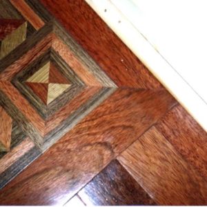

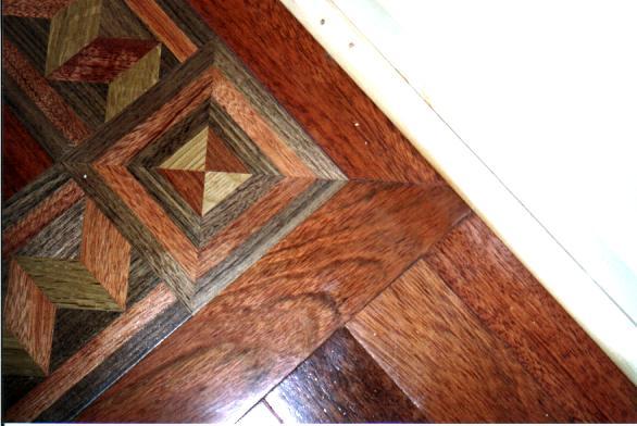

          5. DougU | Feb 14, 2004 09:07pm | #19
            Whats that wood in the pics, and what is the boarder, I assume you buy it(the boarder) that way?
            Nice work by the way.

            JeffBuck | Feb 15, 2004 02:22am | #22
            The field was Bruce 5/16 Brazilon Cherry .. glued to a concrete floor up in a condo unit. The border was from Oshkosh Hardwoods .... not sure what all the woods in there were..... knew at the time ... walnut/cherry/ash ... something like that?
            The border came in strips ... think it was 4 or so inches wide amd about 24 or 26 inches long ...
            the corner pieces had the corner diamonds already attached.
            The whole thing was pieced and glued together on a thin cork backing.
            all edges just square cut .. no t and g's ...
            Lotsa people say they don;t like Bruce ... guess I don;t work with enough flooring to know better .... I like the stuff. Never had a problem installing the stuff.
            About the only flooring I stay away from is unfinished 3/4 ... install and finish.
            I can install just fine .... just not a finish scientist ... that's where the magic happens.
            I usually sub the whole thing out if they want ... "real hardwood" ...
