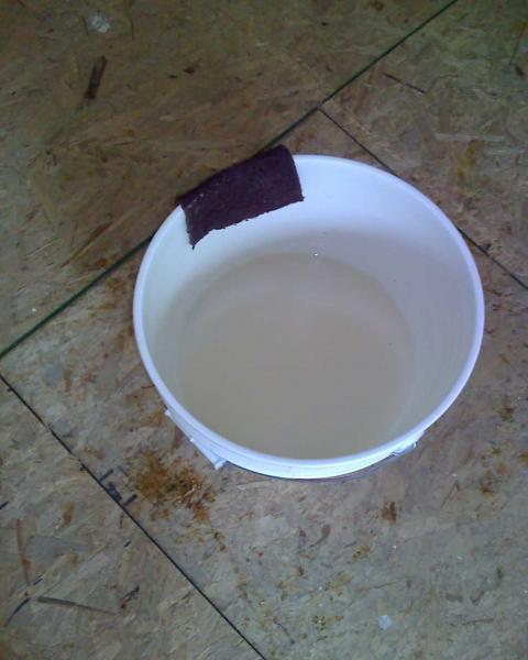

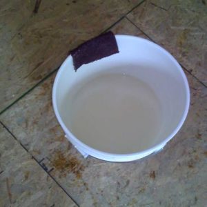

  8. ClaysWorld | Aug 09, 2008 01:40am | #17
    Just say no to boogers
    clean up the bucket when you put it away with a worn scotch brite and water on top of the mud. poor it off at next start and then mix a bit.

      3. ClaysWorld | Aug 09, 2008 04:04am | #24
        Either keep in a water bucket or clean it cause it helps grow little boogers. It will flake off and contaminate the mud.
        If you keep a water bucket handy you can scrap/clean the knives into it and such it just goes to the bottom, as you work and if you need to loosen up the mud just poor some out, the top water is still good.
