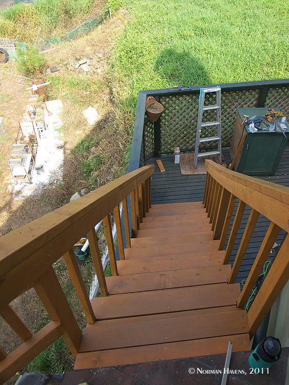

Nothing like intense pain to focus the mind. I’ve always known that these stairs became dangerously slippery in the rain.
A: The stairs as I built them two years ago:

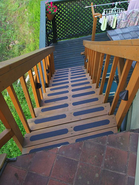

C: Stairs with 3M Safety Walk anti-slip tape applied
Remind me to do this next time before somebody slips and falls.
(The single saving grace this time is that it happened to me and not to a guest.)

    How steep are the stairs?  the treads look to be about 11" wide.  Goos idea to add the safety strips.  There is now a paint-on grip that you could coat the whole tread in the colour you want.

    Noticed you added some low voltage step lighting as well. Great idea!

    help for that tile edge
    BTW-Schluter makes a retrofit grip nosing (just adheres with Kerdi fix)that will add safety and enhance the detail of your beginning tile landing edge. May be worth looking into.
    http://www.schluter.com/8126.aspx
    note: the TREP-GK is the retro-fit profile which is NOT the integrel profile in the photo.
