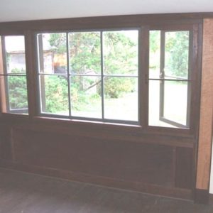

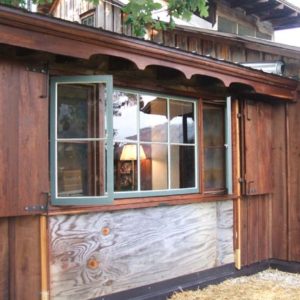

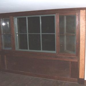

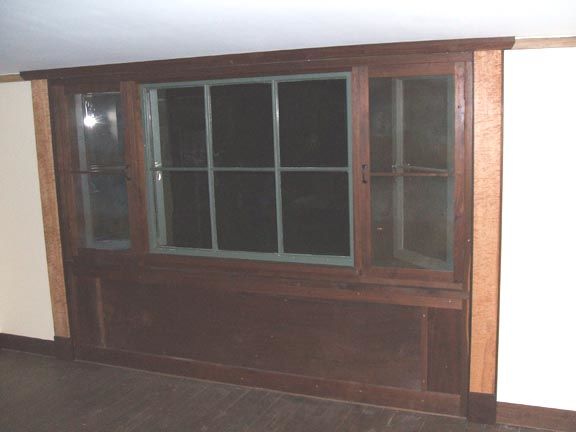

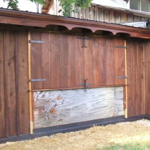

Well, it’s almost done…
I’m gonna post a few picts, even tho I ran out of siding to finish – the way I work it it’ll be a few months before I lumberjack and saw –
A while back Jim Blodgett started a thread on window building 53734.1  that was a tremendous help in designing this unit –
the frame material is black walnut, most from a tree I felled and ‘wood-mizered’ – some from barn salvage aquired several years ago –
there are operable ‘storm’ shutters, walnut board and white oak batten construction – they operate smoothly and should make it easy to live with the single glazed (refurbished/salvage) sash –
it’s been hard to get a good picture inside – it ended up a little fancier than I originally envisioned – I used up a highly figured maple board I’d been setting on for years – it provides a lot of contrast (maybe too much) with the walnut – I believe it will mellow nicely in a year or three –
what was formerly a blind south wall is now a source of light and ventilation – it’s gonna be real easy to get used to –

      1. DavidxDoud | Jul 31, 2007 06:21am | #7
        What kind of finishes did you use? Is it the same for int. and ext.?
        hi steve - thanks -
        the finish is boiled linseed oil on all surfaces - the frame has had two coats - I built it in the shop, then disassembled and oiled all surfaces -
        the siding and such get one coat - slopped on, let set, wipe off before things get gummy - easily refreshed if desired - I pretty much plan to let the outside weather now - if a few years it'll gain weathered walnut character that is so pretty -
        I've seen walnut sided barns that have weathered 100+ years - the walnut erodes, but doesn't rot, gaining tremendous character - "there's enough for everyone"

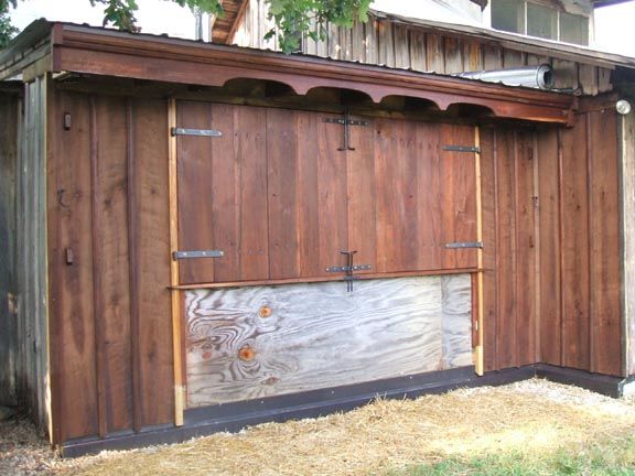

      the hinges you can see have been floating around here for years - they are just the right size - then I had to bi-fold - looking thru the inventory revealed nothing inspiring - stop at one of the local building supplies for something non related, looked at their clearance rack, and there was a whole box of 8" straps - half price - tag had $4.35 each - got the box @ $2 each - got the L-pins for the latch and the small straps they slide thru out of the same pile - 5/16" hooks - I loaded up on a bunch of 'National' hardware for $62 total -
      thanks - View Image

      1. VaTom | Jul 31, 2007 04:02pm | #13
        Nice.  Thanks for the batten detail.  I'd wondered how you were dealing with wood movement.
        Have fixed several exterior shutters here where the designer apparently forgot they were dealing with wood.  Walnut's my preferred shutter wood also.  Mine's all come from logs that a mill wouldn't want.  Last tree that was blown down yielded nearly 500 bd ft, with careful sawing.PAHS Designer/Builder- Bury it!
        1. DavidxDoud | Jul 31, 2007 11:10pm | #16
          ya - I basically copied the construction of various vintage B&B doors I use/have in inventory -
          the three boards that make the shutter are 10"-6"-10" to make the 26" width of the panels - I like to use a tougher wood for the battens than used in the panels, so white oak it was - View Image
          I pulled the tongue and groove panels semi-tight together with bar clamps, then released the tension, leaving the clamp with just enough pressure to keep things from moving as I screwed -  I don't expect that swelling/shrinking will create any real issues - the T&G design is such that the front is 'tight' and the back not - if it swells much I don't think there could be enough compression as to warp the battens -
          -  no glue, I oiled the back of the battens and the area of the panel before assembly - torx head deck screws every 1.5" or so (a modern substitute for the nails in the vintage doors) -
          routed the hinge straps flush with batten for a slim profile, tho I still had to bore a recess in the window frame where the bolt head interfered when the shutters are shut - View Image

          3. DavidxDoud | May 27, 2008 07:01am | #20

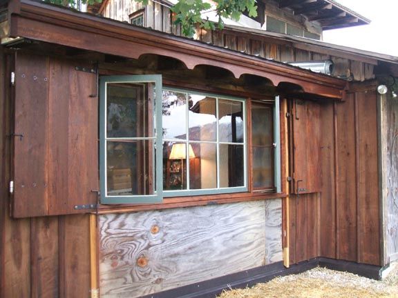

            I'm sure you've all been wondering -
            I did get it finished -
            casements and shutters work as easily now as ten months ago -
            the wall/shutters are beginning to acquire some character from the exposure - only negative is some deterioration of the bottom row of glazing compound - guess I should have painted it -
            View Image"there's enough for everyone"
