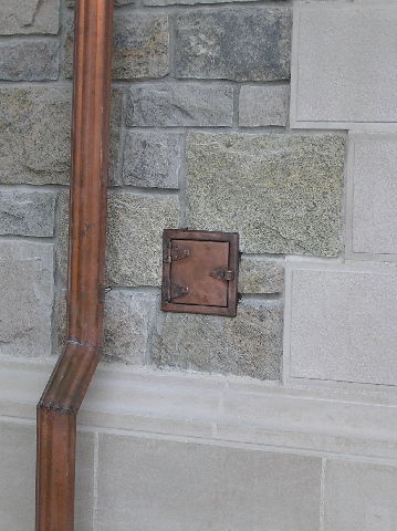

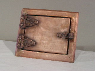

I built this door, and several others, to hide high tech touch pads on the outside of a very traditional house. I had fun with the project, creating the design and all parts including hinges from scratch. I even made the hinge rivets from 1/8″ square stock. This week, I get out the hammerdrill and do the install. I’ll post the results if any are interested.

I built 3 of them, each a different size, and right now I have about 12 hours in them total. I'm way to slow to be a going concern, but this client is priceless.

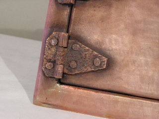

On the copper door:
Are the hinges welded to the door and frame? Are the rivets just ornamental or do they provide structural support?
Is the distressed look just from heating and hammering the copper or did you use some other tricks (Actually that rough look is just about what my welding looked like with my new MIG welder that I haven't gotten the settings down on yet...).
The rivets are for real, they are 1/8" square rod that I cut on the shear. I drove them through and heated the ends and hammered them tight.
The finish is a combination of hammered hinges and liver of sulfur patina. The patina is activated by heat and then I scotch brite off the heavy stuff. I did leave some of the original heat and welding marks, nothing like stress to add beauty (you should see me)!!!!

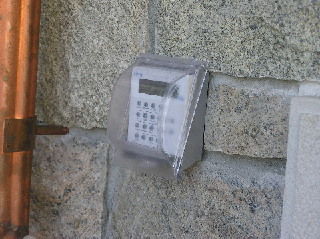

Here's the door installed.
very nice touches, your door will make a very welcome addition to that front entrance, as it stands, that plastic box looks like sheet.
