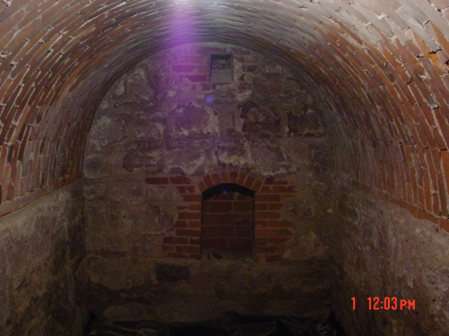

I recieved a call from a previous customer they asked me if I could convert this cave into a wine cellar.It was in an old house ,built
around 1910.You had to go down a small flight of stair from the basement.It had a
dirt floor ,that was slightly muddy.
Please bare with me ,I am learning to post pictures.

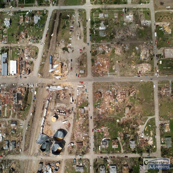

Prosecho, is this room located in Nebraska??
'Nemo me impune lacesset'No one will provoke me with impunity
Na, my vault is a square room with concrete floors, walls and ceiling.
Yes Raz
Its in Hallum Nebraska where they had a major tornado 2 years ago,took out almost the whole town,This guy and his family missed the big one buy a mile or so.He only had some lose tin on some out buildings that i fixed in a day.
Edited 2/3/2006 12:27 am ET by prosecho
Holy cow, It's always amazing to see tornado shots like that. One came by here about 20 miles away 20 years or so back.
Wiped out a large area. Houses sitting on top of houses, large trees looking like broken matchsticks with no limbs, all leaning the same way.

More pics here kind of slow loading
http://www.dnr.state.ne.us/floodplain/mitigation/Hallamtornado.html

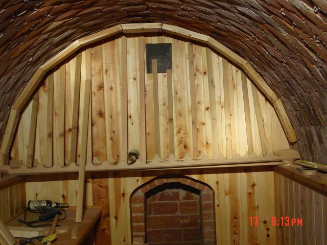

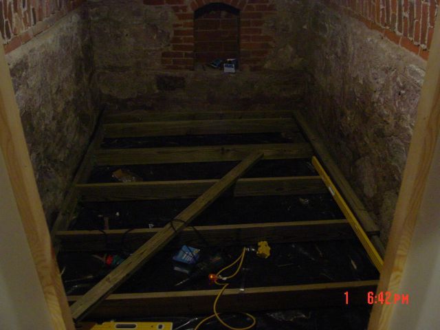

More pictures of the evolution of the cave.
Edited 2/5/2006 1:17 pm ET by prosecho
again, nice work.
But I'm guessing it was good to get finished and see the light of day.
you got that right ,in a basement of a basement.By myself.Lots of trips
