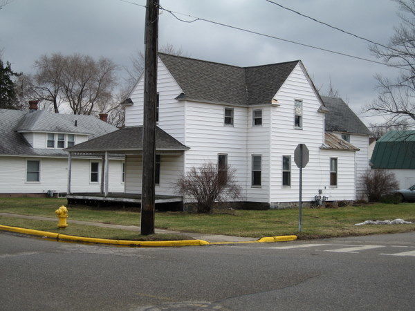

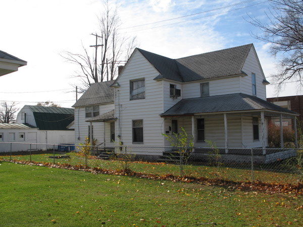

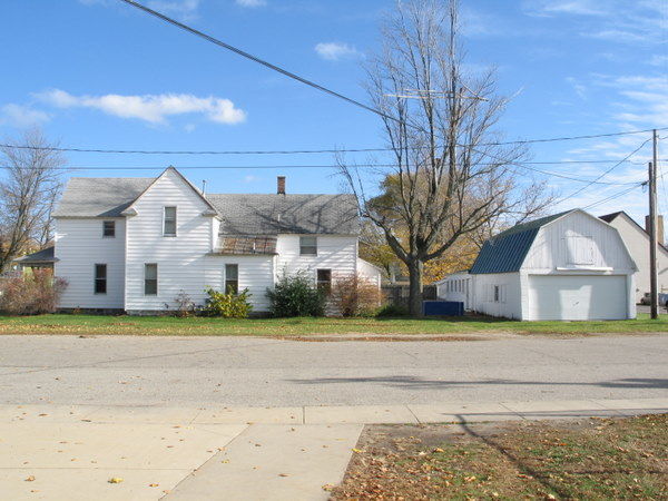

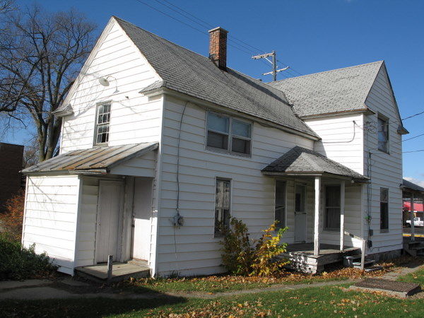

My wife and I bought this house 2+ years ago as a fixer upper. I’ve been working on it since. The house was turned into a duplex by a previous owner and was in poor shape. Our intention was to make it a whole house again. We needed to put the stairs back where they had originally been. The project morphed into something that I never expected. I never intended to take the house down to the studs… So, here it is, my house of projects.

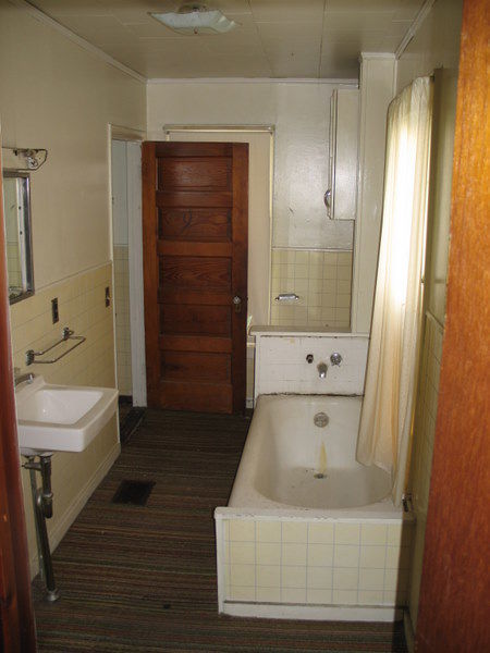

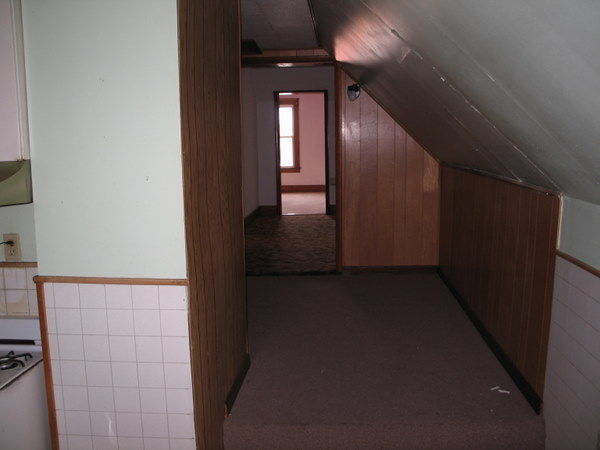

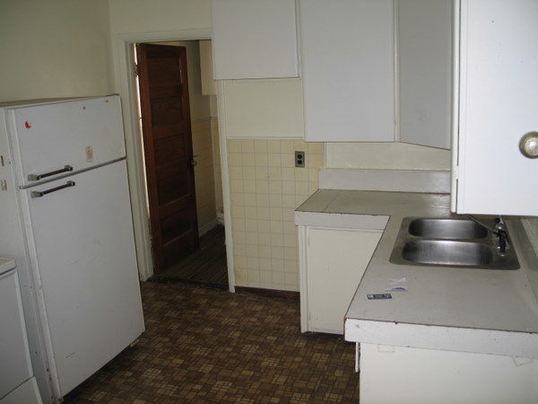

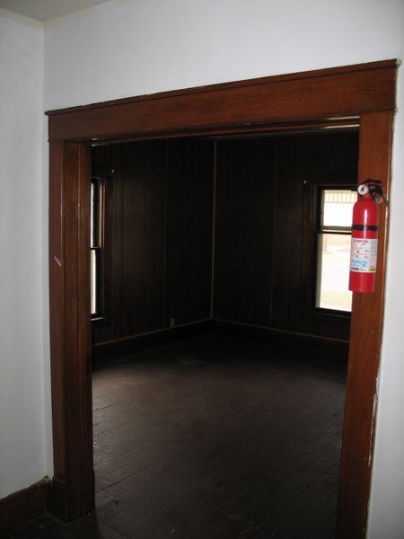

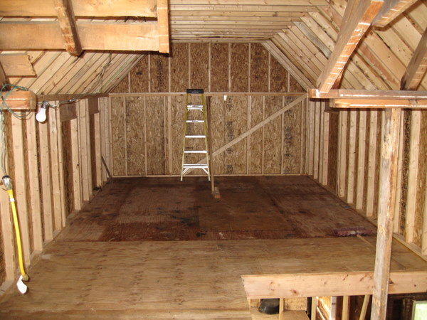

Here are some various interior shots.
I ended up gutting the entire house. Should I have? Thats a great question. If I had known then, what I know now... The house had "great bones" as my sister called it. The structure was not rotted at all except for a little area where water had gotten though the soil pipe flashing in the bathroom. The difference in floor height got me to thinking that it was going to be an interesting master bedroom with stairs, or the roof needed to be raised...

Hugh, I like the fire extinguisher on the door casing. Nice touch. ; ^ )

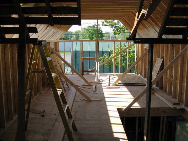

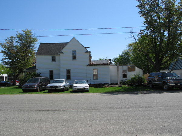

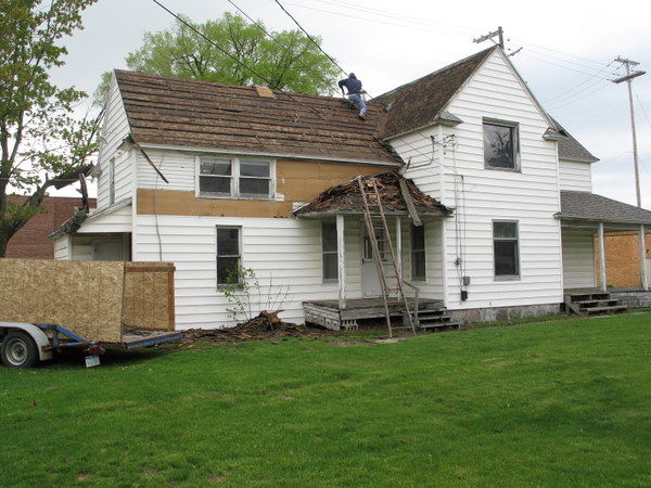

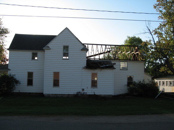

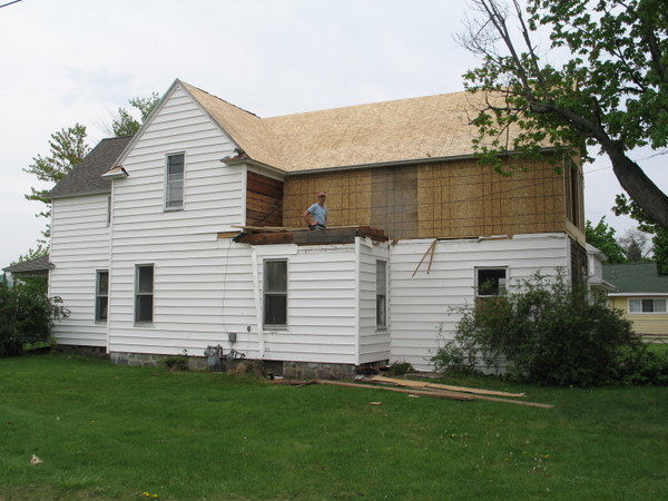

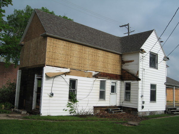

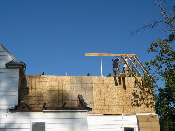

Well, I decided that there needed to be a little more headroom on the south end of the house. Why not raise the roof? After pondering cutting the roof loose and having a crane lift it while we rebuilt the floor and walls underneath, I decided the easiest and safest was to just tear off the old, and start fresh.
I made the mistake of loading all the shingles in a trailer instead of getting a dumpster because it was "cheaper". Well, I learned my lesson after it took 3 HOURS to unload the matted mess at the dump. I see where a dump trailer would be really handy.
My brother and I had the roof down to the old rafters on a friday night, and by Saturday evening we cut down the old walls, put in new top plates (old balloon framing), put a new floor in, built the walls and new rafters in place. It was a little disconcerning with a quarter of the house missing, but it was quickly replaced.
-h

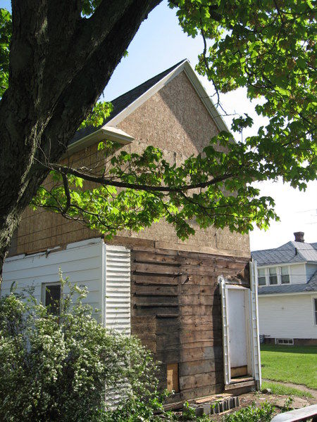

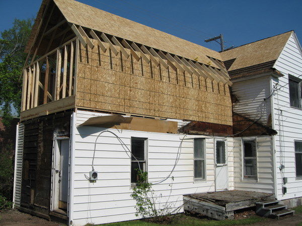

More raising the roof pictures
I wanted to match the existing fascia and rake detail on the rest of the house. It proved to be a time consuming project. I intended to paint it so I tried the exterior product Mira-tech. I had wanted to use Azek, but I was trying to control costs too. I wasn't thrilled with the Miratech. It seemed to blow apart using a 15ga. nailer. I ended up wraping the whole house with aluminum.-h

Job looks good! I like your style, gut the damn place completely and go to work, makes for an easier time.

I kinda like that second floor deck you've got there. Almost a shame to cover it all up ;)
