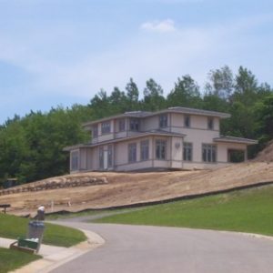

        I like the idea of a top floor 900 sf master suite. I like the stairs for exercise but I'd still want an elevator in for visitors and EMS guys when they come for me.
        No, I never built a house in Lansing. Here's one I did for a guy in Milford. It's a Wright style house.
        blue

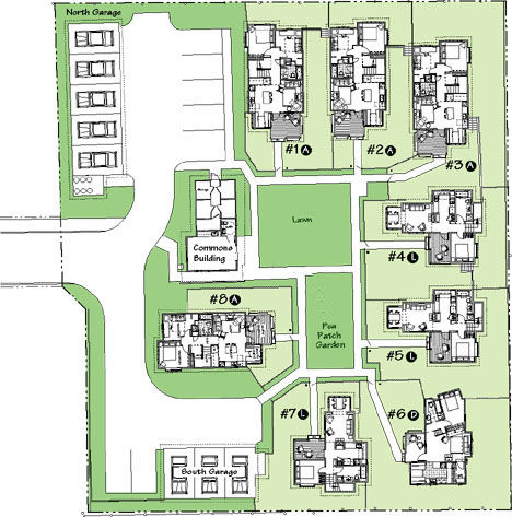

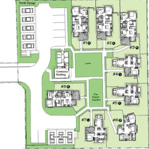

    Susan has some nice plans and detail. I am hoping to incorporate a small village section of cottage homes in a development that is in planning.
    It seems Ross Chapin Architects have been involved in these types of plans and developments. See:
          http://www.rosschapin.com
