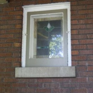

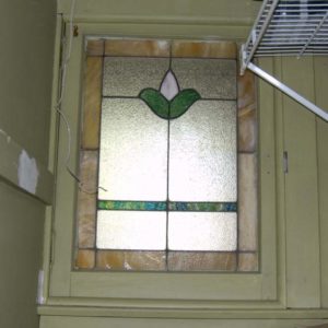

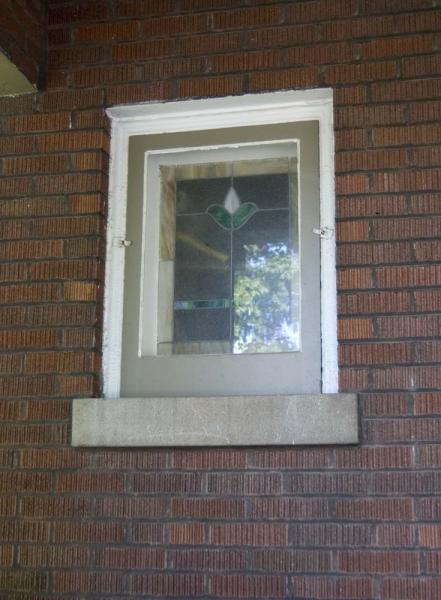

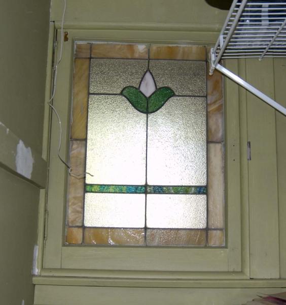

I would like to add an accent light to an old stained glass window so that it can be see at night. From the attached images, can anyone suggest a method of lighting this window so that it will be as evenly lit as possible?
I am assuming that I will have to make a light box of sorts to make this happen. What I envision is a fluorescent tube on each vertical side of the window whose light will bounce fairly evenly off of the white face of this light box. The fluorescent tubes will have to be off to each side sufficiently so that they will not be visible when the window is viewed from the front of the house.
Does this make sense? The approx. dimensions of this window are 24″ (vert) x 18″ (horizontal).

I can't tell what your ceiling height is from your pictures. We have added back lighting to art glass windows by puting eyeball canns in the ceiling. By setting them back far enough, you get the same soft diffused light that get from a closer flourescent.
Dave
Woo-ooo, weee-eeeee!Dave! You da, Man!That's the best idea yet. I've got about 2' of ceiling height above the top of this art glass window. The existing closet light is above and about 42" from the top edge of the window. This may be a perfect solution.This will certainly solve the even lighting issue and would be a simple install. I can power the accent light from the closet light, use a timer of sensor to control, use a dimmer switch to trim it just right, and I'm good to go. Simple.Thank you very much for your suggestion. Pizza's on the way.Phillip
