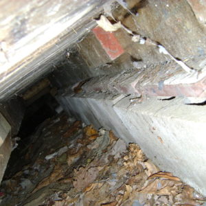

I’ve attached some pictures of a front porch that is sinking on the front end. It was clear to see why it was failing after I stuck my camera in the concrete opening underneath and shot some pix.
The only support is a combination of concrete blocks stacked together.
I’m seeking advice on how to handle this situation, as far as what needs to be done in order to be able to get a new floor down. I wasn’t expecting to see the whole front of the porch being supported by cinder blocks???????

    Where are you, and what's the soil like?  In southern climates, where there's no frost to speak of, with reasonably stable (non-loamy) soils a porch foundation like that, while not ideal, isn't terribly terrible.  If the sinking has occurred over a period of decades (the house appears to be at least 50 years old) then it would be reasonable to just jack up the front rim and insert another piece of treated or some such.

        By "insert another piece of treated", I mean below the existing rim joist or whatever -- don't necessarily muck with the framing other than to jack it up.  Of course, how you do this (or anything) is hard to say -- it's a pretty tight crawl and hard to tell how it's put together.
        In NY I would hope that the soil is a bit gravely and well-drained, or else frost heave will jack up the deck several inches every winter.

          I see what your saying about "inserting a new piece". What do you think about jacking it up (however that can be done) and removing the "red brick" that is on top of the cinder block and inserting a 2x(?) or such on top of the cinder block? Maybe wrap it in a membrane or such????
          I like the idea of leaving the existing frame work if possible. I would have to remove the floring to be able to do any kind of jacking etc...to small to work under, not to mention the "critters"....yikes!!!!!!!!!!

    I'm a pragmatist so the first thing I'd want to know is how old is the porch and what's your budget?  . I don't see anything in your pictures that really alarms me. I'm not saying it's ideal but if it's 60 years old and has lasted this long it will probably last another 60 with some new decking and some posts underneath. Any level of repair from an expensive  total tear down to an inexpensive one day fix up is possible, it's all about time and money.

        Actually if it were my house I'd take the decking off, replace those blocks with a couple of posts, try to support any place else where it needs it and lay down some new decking. Now, if there's rot it's a different matter and then I would replace any wood with rot with PT  then redeck. You'd have to drag me kicking and screaming to tear it all down and rebuilding because of the time, cost and value.

    Looks like the joists could be undersized/overspanned.  The stacked blocks in the dirt might have been an attempt to shore that up.
    The shot of the front seems like the roof line is high in the middle, drops off at each side.  (not the gutter which exagerates it, but the fascia line.  Yes/no?
    You need to look at the whole picture to see your options and how they effect each other.  Plan you attack accordingly.  Flooring can be pc'd in, joists can be shored up (best on a footing if you can do it).  Rot in joists or plates need to be repaired or replaced.

        From here, can't see much.  However, the span of the ?2x6? joists, what's the builtup beam?, they put those couple stacked block there for a reason, probably spongy or dipped because of the front foundation.  One of your shots shows a couple missaligned block under the rim joist (or beam) along the front wall.  That needs repaired.  The short wall on top of the flooring?-the way that wall traps water/snow-sure place for problems to happen.
        The grade on one of the left side shots-it goes back and down the side of the house.  Any water needs to be redirected around the porch to keep that under porch area as dry as you can.  Any coatings on the existing porch can be pushed off by moisture picked up from the unpainted underside.  New flooring-paint/seal all sides b/4 you put it down.  Keep fall in the porch towards the outside.  Change the shortwall so water can drain under and off the porch.

          Yes, i noticed thosw "misaligned "block also, and agree about the short walls being a water trap. Good post, appreciate the thoughts and advice.
