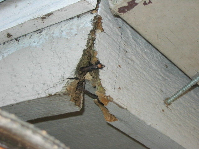

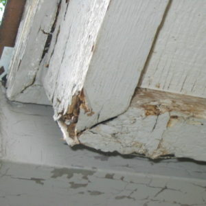

I’m ready to get after this problem and solve it.
The fasias & rakes on my 5/12 pitch roof are made of rough cedar, approx. 1-3/4″ x 5-1/4″. The facias aren’t plumb, but 90deg to the roof deck. Over the years the miters have opened up, and on two, the bottoms have rotten out.
I fixed one bad one by cutting out all the rotten wood and replacing it with new. It was a pita.
These others I’m looking at using either epoxy or fiberglass. I’ve also seen the ad in FHB for Abalon?, sounds like epoxy.
My thinking is on the bad ones (where the bottom is rotten out), to build a non-sticking form of some sort, attach it with drywall screws, kick off a batch of epoxy or ‘glass and pour it in from the top to fill up the cavity.
I could also add some filler, chopped mat or micro-balloons or even use Bondo, mix it to peanut butter and fill it in that way, but this might leave voids, which I want to a-void.
I also read somewhere about drilling holes into either side of the fascia, going deep enough to hit solid wood, then gluing in a similiar sized dowel and trimming it to length. This would make for a stronger joint, take up some volume to reduce the amount of resin needed and keep it from just being a ‘plug’.
Any suggestions? Send ’em on . . . .

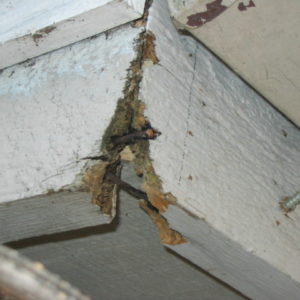

    Here's some photos. Just realized I doubled one, oops.

      My response is much simpler than epoxy. Repair the wood. Fill any open cracks with flexible and paintable caulk. Paint it well with a latex paint. Keep it painted. The skin of the paint should never be broken. If it is, caulk it closed with a flexible exterior siding caulk. With this system, water never gets in to do any damage. Check once a year for caulk touch up issues. It will take you ten minutes to walk around and hit any area that looks like it's opened up. Paint again when the paint starts to fade, chalk or crack or ten years, whatever comes first. If you follow that routine, you're wood will outlast you without any expoxy. The thing I see is that your paintjob was at least 5 years overdue...maybe more. Bob's next test date: 12/10/07

    Here is the system to use - http://www.advancedrepair.com/architectural_epoxy/artssystem.htm
    Scrape and cut back to sound wood.
    Remove the ferrous fasteners.
    Screw in stainless screws or siding nails that will fall in the plane of wood.
    Treat with Primatrate -    View Image
    Finish with Flex-Tec HV - View Image
    Read testimonial here - http://www.advancedrepair.com/architectural_epoxy/architectural_epoxy.htm
    Texture the epoxy before final cure to look like rough cedar (easy) and paint after cure.
    Your investment will be about $200, including a $125 +/- special 2-part caulking gun

  4. toolbear | Jul 23, 2008 09:42am | #6
    You have a nice case of brown cubical rot. Very popular.
    It can be repaired with epoxy. There are a number of systems. Sure don't suggest bondo for anything exposed to weather. Polyester resin does not stick to wood that well. Epoxy does.
    I like and use the WEST system both on my boat and on the job. They have metering pumps which make it very fast and easy to get the right proportions the first time. Just push each pump the same number of strokes and mix. Add micro balloons, milled fibers, sawdust, whatever.

  5. YesMaam27577 | Jul 23, 2008 03:02pm | #7
    Cut it out and replace it again, but this time do two things differently.
    1. Use a rot proof material like fiber-cement, or PVC.
    2. Find out where the water is entering -- its coming from above, causing the miters to start the rot process, and then to open.
    Oh, and while you've got the facia opened up for repair, check the subfacia for signs of water. I'll bet its been there too. And maybe even on/in the soffit boards.

    1. sleddriver | Jul 24, 2008 08:34pm | #8
      Thanks for all the replies.I've researched several epoxys, price varies widely. I saw the thick paste that mixes as it's squeezed from a caulk tube, ingenius! Bondo is out, too inflexible. Filling in something from the bottom is fighting gravity, so I'll remove some of the roofing & deck and go in from the top, using a reusable greased form below to keep the epoxy from running out the bottom. If I use a piece of rough cedar or hardiwood for the form, it'll leave its impressions in the epoxy, helping to disguise the patch.With daytime temps hovering near 100, I'll have to store the epoxy indoors to get any decent pot life, even with slow hardener.In several corners I inspected, the decking didn't completely cover the fascia. In one case, it was short enough to leave a gap where I could put my finger into the attic! Just shoddy construction . . . I want to fix this first before the new roof is put on. I'll post some pictures

        Jeff_Clarke | Jul 25, 2008 04:20am | #10
        Using Flex Tec HV, they provide helical mixing nozzles but they create too much back pressure (too slow) for major repairs.
        What I use is a plexiglas hawk - or even just a piece of plex (or plastic) upon which to mix.   It doesn't stick at all well to plastic, so you can easily form, for instance, an inside corner with some pieces of PETE or whatever cut from plastic items (staple to the fascia).  If you use two pieces to form the back side and a piece on the bottom you should have no trouble finishing it leaving the other (exposed) side unformed.
        You want to make sure to fully mix for at least 5 minutes - more in cooler weather.   Use plastic spackle tools for all operations - again it doesn't stick well to plastic and metal tools will tend to pull epoxy out of filled areas.   By inserting a few ss screws, you pre-reinforce the area.   You can also embed aluminum angle or flat stock in such repairs for very high strength - I wire brush the aluminum first for good bonding.
        A really great trick for rotted sills (a common problem) is to cut a piece of plex the exact size of the sill, butter up the repair and embed the plex in the top, moving it a little to eliminate air pockets.   The next day you can pop it off and have a pretty smooth surface to prime (or fill minor areas with wood filler).
