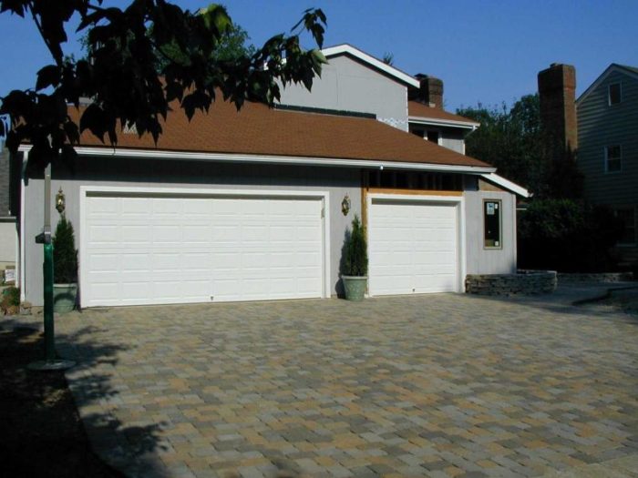

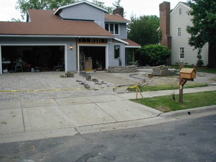

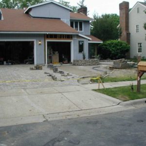

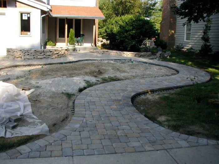

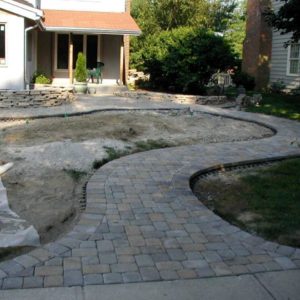

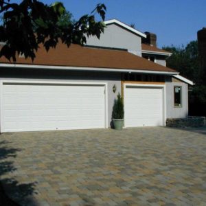

  5. Flury | Apr 30, 2003 10:24pm | #9
    The base is three feet of sand and currently has a 3" top layer of lime rock.  I could remove the lime rock and get more sand.
    I'm no expert on the matter but I did put in a couple of thousand sqare feet of concrete pavers last year for driveway and paths...
    I think that you may be asking for problems having sand under the limestone.  I think that I went through about 80 tons of crushed limestone compacted in 2" lifts under all the pavers.  Sand (1 1/2" uncompacted) is put on top of the limestone, screeded and then the pavers are placed and compacted.
    The deeper and more compacted the limestone base, the more weight the patio blocks will be able to support.  You could try sweeping dry mortar/cement into joints which may help unify the entire surface.
    If you were to use concrete pavers you could always re-use them in a garden path, but you would have to deal with the joints while moving your tools....
    Just my thoughts....
