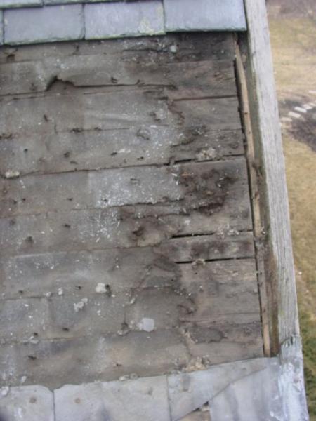

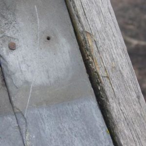

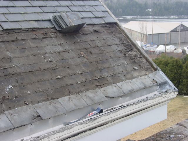

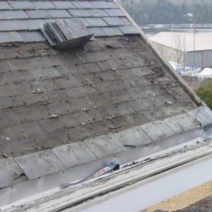

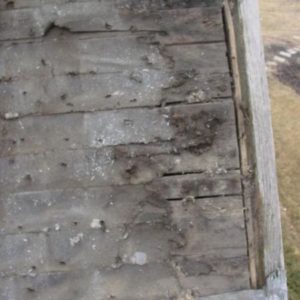

Starting back up on a roof restoration from last fall.
These pictures show a large rake moulding which sits above the roof plane, in a sense “housing” the slates. It makes wind less likely to be able to wreck havoc with these edge slates.  Note the recess in the moulding which acts as a trough to let the water flow to the gutter.
We’ll do a more thorough job in the laying process.

    Are you planning on repairing it or eliminating it or just leaving it?  I would think if you could mill somthing out of Azek to match it, you would be in business.
    1. theslateman | Apr 05, 2007 12:31am | #5
      The owner is an architect so I'll have to clear details with him.
      I'm inclined to flash with each course of new slates a soft copper that covers the wooden rake and is locked onto a drip edge on that rake trim.

    Is that common or traditional? A period detail? For higher wind locales?
    It's not something that I've ever noticed before here on my part of the Connecticut shoreline.

      I've roofed a couple of houses with that detail. Never seen it without flashing on top of it, though. Last time I saw it, we were installing copper standing seam (tore off three tabs - I'm guessing slate was original). We had to fur up to it with cedar shingles.http://logancustomcopper.com

      I've seen it several times- mostly on coastal locations, but as Grant notes in the next post, never without flashing covering the exposed wooden rake trim.

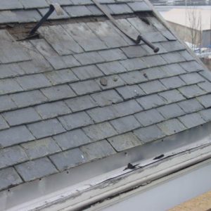

          Mongo and all,
          Here are some shots from today on how I choose to redo this rake trim with copper and slate.

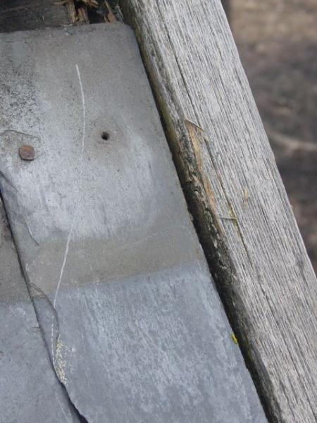

            Some more pictures of this rake trim.  Had to remove a short length from the North side for a pattern since the eaves section was gone, and to lengthen for the miter.
            You can see the meat on this is great- the wear taking place where it's been exposed for eons. This side shows more deterioration, so before covering with copper I'll use Abatron A and B liquid consolidant to fill the fissures.
          12. seeyou | Apr 19, 2007 01:45am | #23
            What kind of wood is that, Walter. I can't see the grain well. I'm guessing some kind of pine. BTW, nice plastic gutter hangers. I'm guessing circa 1780 on those.........Oh yeah, Abatron has saved my butt many times - good stuff, but hard to work if you build it out too far.http://grantlogan.net/
          13. theslateman | Apr 19, 2007 02:57am | #24
            Grant,
            Yes it's old growth pine. Thats the only reason it has withstood all these years being out to the weather.
            When this house was built, around 1835, Bangor- which is 10 miles upriver-was one of the largest producers of lumber anywhere.
            The Abatron I'll use is the two part liquid consolidant to help seal those fissures. It's a big difference from the South side which was in real solid shape.

          15. DaveRicheson | Apr 12, 2007 01:17pm | #12
            Whats zat?  I don't know squat about slate roofs, but enjoy seeing your work and learning.
            Dave
          16. theslateman | Apr 12, 2007 01:36pm | #13
            Dave,
            You're looking at a Sieger snow guard installed into the roof- then the flashings to cover the rake trim which stands proud of the roof.
            There is a porch below of low pitch which we don't want snow to slide down an exacerbate the potential for build up and back up.
