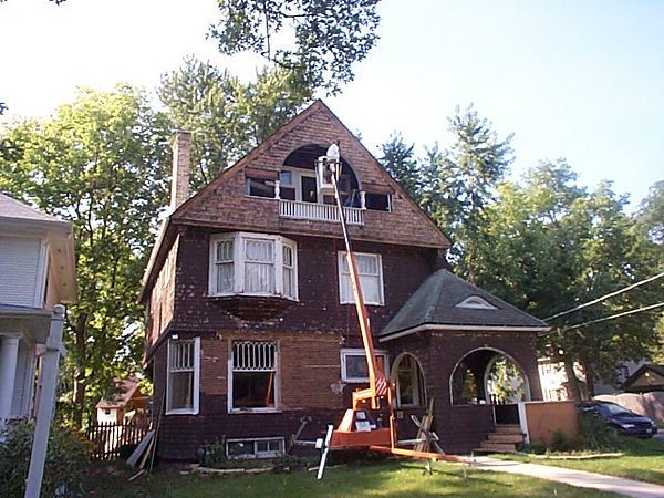

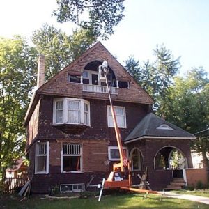

    I have used the Silent Paint Remover extensively. I find it works very well on multiple layers of old paint. Supposedly it uses infrared heat which goes through the paint layers and heats the siding which then releases the paint. The paint comes off in large soft clumps which dry to large hard clumps. Small particles of dust are minimal. As long as you tarp well cleanup is easy. Supposedly the SPR does not get the paint hot enough to release the lead. Not sure if that claim is correct or not.
    On clapboard this tool rocks. On my 1890's house is took all 7 or 8 layers of paint off the clapboard at once down to bare wood, in one pass. After scrapping the wood is smooth and requires little sanding or repairs, see attached photo
    Unfortunately for me I have a Shingle Style house which is 75% cedar shingles. The cedar shingles were a little more difficult with this tool as they have a little grain which holds the paint better. Seems like the tannin in the cedar causes the heated paint to harden faster. It wood probably be easier to just replace the cedar shingles, but would cost more.
    The only problem I have had with the SPR is using in under roof overhangs. An old birds nest in the soffit caught fire. Luckily we had the hose nearby to put it out.
    Good Luck what ever method you chose.

      Here is the "After photo". Still have to pop out the windows and redo them.
        Crash | Apr 13, 2006 12:31pm | #8
        Wow!  That's gorgeous!

        1. MikeK | Apr 15, 2006 04:10am | #14
          Working by myself it took me about 6 weeks to scrape and paint the front of the house. It worked out well because I had a month off work between jobs. The clapboard was a breeze, but the cedar shingles took longer. I rented a man lift to work on the third story gable. The cedar shingles appear to be original from 1892 based on the number of layers of paint. Amazingly they were in very good condition. This is the North side of the house, so it gets very little sun. The Back of the house, the South side, the shingles were in much worse shape. We ended up residing the back of the house with hardie plank.I can not stess enough how well the Silent Paint Remover works on Clapboard and other flat, smooth surfaces.
          1. philarenewal | Apr 15, 2006 04:44am | #15
            >>"can not stess enough how well the Silent Paint Remover works on Clapboard and other flat, smooth surfaces.
            You've got a convert.  Looks darn near miraculous.
            "Let's get crack-a-lackin"  --- Adam Carolla
