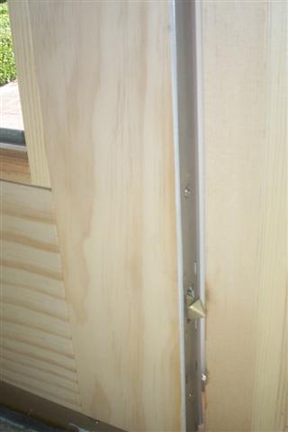

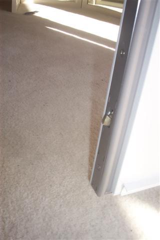

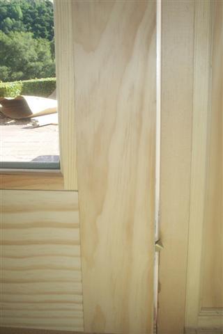

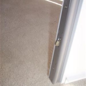

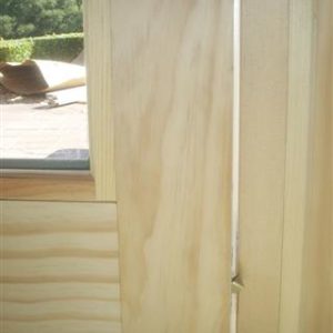

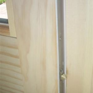

            I remembered my camera today and took these pictures.  Any advice welcome.

            If it's any consolation, Pella's must be going through the same sort of "drooping bolt" as the andersons.  On their 3pt locking system I have recently seen 3 at about the same age (5-10yrs) where the center deadbolt which should only be activated by pulling up on the handle, creeping out.  On occasion the same with the top/bottom pins.  Their solution if within that 10 yrs, supply the whole full ht. mechanism.  Under 5 yrs, includes the labor to install.  Very funny that one of the doors is in their "new swanky" showroom.  Not good planning there using that older display.

          3. Dave45 | Oct 28, 2005 03:54pm | #14
            Yours comes like there's with just the handle  needing installed, no?
            Yep.  They come out of the box with the latching mechanism installed and there's a square "allen wrench" in the parts bag to work the latch until the actual handles are installed.
            We've also had a problem with one of the deadbolts.  When I was closing up last night, one of the deadbolts wouldn't close and we had to reinstall the deadbolt knob.  It finally worked but not smoothly.  It feels like it wants to bind up.
            I also have to say that I'm not very impressed with the factory caulking.  Apparently, they run beads of caulk at the joints of the head and side jambs and at the threshhold.  The caulk squeezes out during assembly but isn't smoothed out.  Most people probably wouldn't notice, but it looks pretty tacky for a top-of-the-line (i.e. $$$) door.
