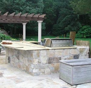

They had this stone BBQ built and didn’t wanna
use a solid surface top. She wanted it tiled with
these custom made tiles . Pretty much a
nightmare of a job!!
In spite of how horrible I know it is to use
PT plywood I took the chance. ( i wrote in the
contract that there’s no guarantee on the
longevity of the work…but I’m SURE it’ll last a
lifetime) I actually bought
an extra 1/2 dozen sheets of ply so I had extra to
choose from and thank gawd I did have the extras.
I used 2 layers of 3/4″ ply PL Premiumed together
and SS screws.

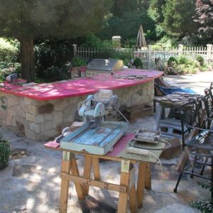

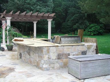

I first framed the inside of the BBQ top with
PT 2×4’s. I used a 16 footer for the front curved
side banging in short ones to bend the long boy
into place then shot everything into the concrete
with my Remmington gun.
I also had 3/4″ thick X 18″ L brackets made up.
I notched the top of the concrete 3/4″ deep to
recess the top of the brackets flush and bolted
the other side into the inside of the island wall.
This supported the front cantilevered top
After I had my top on I ripped a piece of 16′ 2×4
into a sliver about 1/2″ thick that I bent along
the top of the front of the ply till it had the curve
my customer was satisfied with…scribed it and cut
it with my jig saw….then belted it smooth and even.

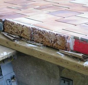

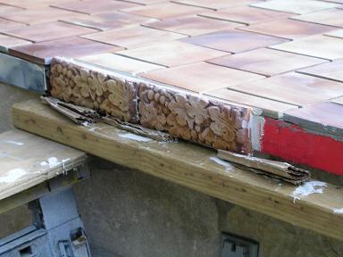

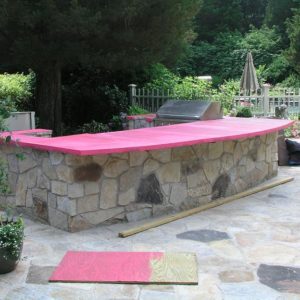

Then I thinset on some 1/2″ wonderboard to the
entire top. Ripped some 2″ strips of WB with my
grinder and thinset and nailed that on the face edge.
I then put two thick layers of Regard on all the WB.

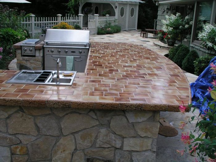

Then I tiled the top and did the edge/border tiles
with Quick set thinset. I hung 2×4 ledges with
clamps to support the edge tiles for an hour or
less till the quick dryin’ thinset dried.
A lot more went into this than i even wanna
remember…ugh.

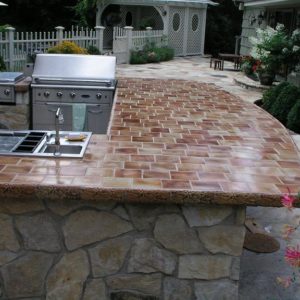

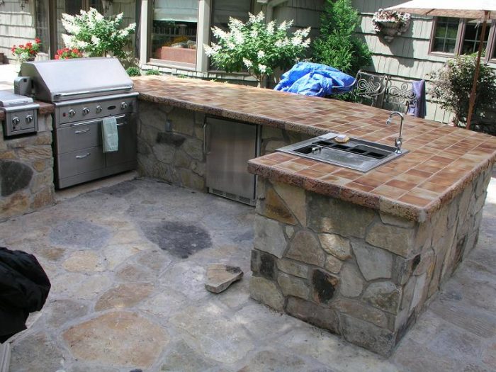

Those border tiles? they’re about FIFTY BUCKS EACH!!
That entire top…top only…cost them about TEN GRAND!!
Thank gawd I’m done. I could have rebuilt the
twin towers in the time this thing took to build.

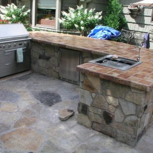

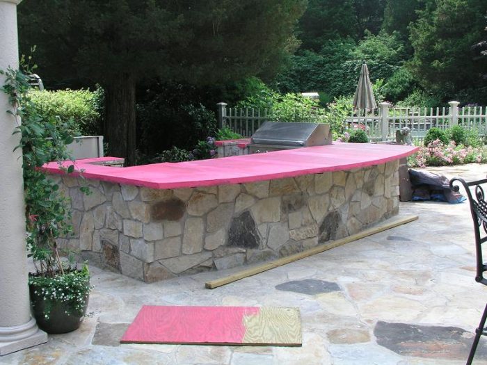

BEFORE
2 layer of 3/4″ PT ply over 2×4 PT framing
Redgard over Wonderboard

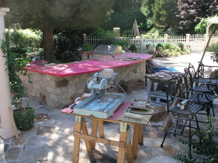

Laying out my tile plan
My border tiles ( I switched to dark thinset)
All my tiles are on…whewwwwww (pre grout)

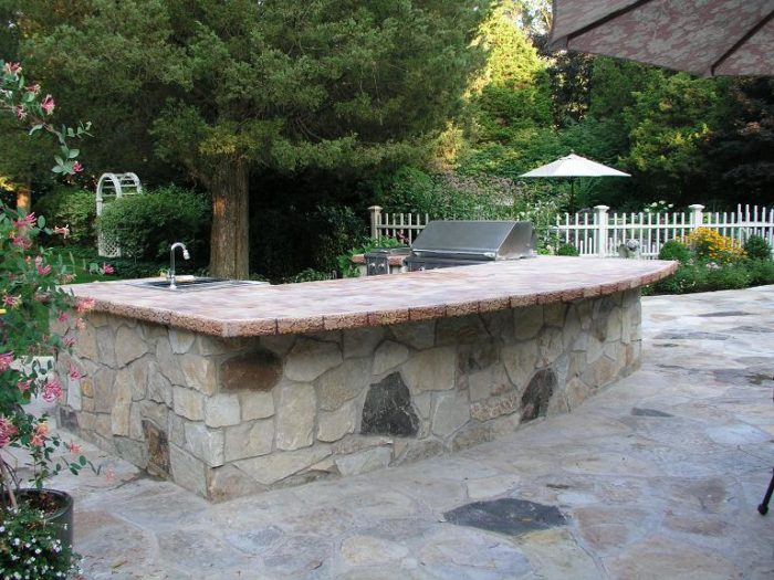

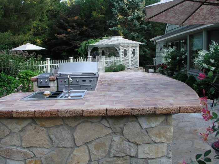

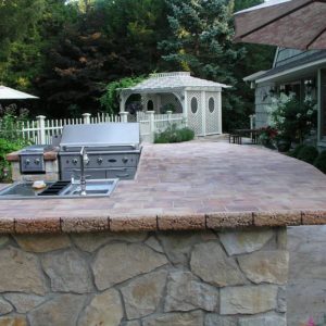

From the front
Almost home..(grouted and cleaned up…whewwwwwwwwwwwwwwww)
Fini’ $$$$ : )

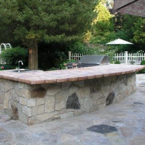

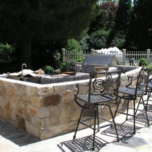

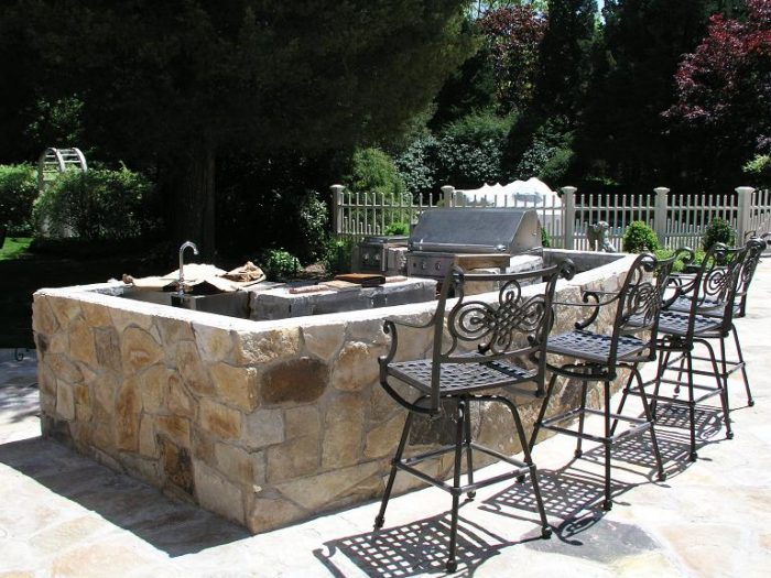

That looks really amazing, but I'm having a problem with scale. Can we get a human standing in there (or sitting on the outside) to give me the scale?
"A little 'enthusiasm' and all problems seems small!"
Edited 8/14/2008 11:45 am by JohnT8
You'd have to pay me big bucks to go back there...lol.
It's about 16' long and about 10' -12' wide behind that BBQ grill
'bout 8' behind the sink.
I forget how high but you can see in the first pic of the bar stools to get an idea.
You wouldn't belive what those stools cost....and theres lots of those chairs around the back patio and pool.....whewwwwwwwwww. Bar stools are about a thou each. Wanted to kill myself when I found that out and thought about what I charged....grrrrrrr

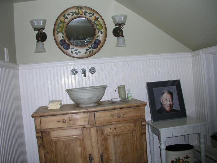

View ImageI have trestle sinks all though my house in the bathrooms....cept mine are country. One I had made by a potter in Vermont.
Takes more work to keep the counters dry but I don't care cause I love those kinds of sinks.
Here's the one the potter in Vermont made for meView Image

Redgard is an incredable product!! Expensive but well worth the added insurance and super easy to apply http://www.custombuildingproducts.com/ProductCatalog/SurfacePrep/WaterproofingAntiFractureMembranes/RedGard.aspx
After I did two heavy coats of Redgard I had to cut a tiny section out to alter the top a hair and the dried Redgard was a really thick rubber I peeled off the top of the piece I cut...it took the top of the Wonderbaord with it which meant it really stuck well...the stuff was a seriously thick coat of rubber membrane embedded in the substrate. I can totally see how it water PROOFS and make it real crack resistant. NExt time I do a shower and don't use Kerdi I'm "definetly " using some Redgard.
It's about $50 a bucket. That top took two buckets and I put it on real thick with a 3/4" nap roller. Washes off the roller easily too with water while it's still wet.
