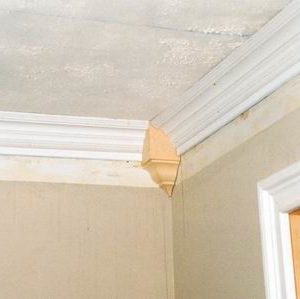

I’m trying to make corner blocks for my crown.  Here is a link to an example:
https://images.finehomebuilding.com/app/uploads/2019/01/26012038/5a9c2330.jpg
I’m having trouble figuring out what the correct miter and/or bevel angle should be set to when cutting the crown that goes on the bottom of the block.
I cut the crown (bottom side up on fence) with a 45 degree miter.  The problem is that the crown doesn’t come to a point.
Can someone show me the correct way to figure out the angles?  I thought it was similar to cutting for an outside corner but it didn’t work out.

    Looks like a standard outside corner to me. I cut my crown standing so it would just be a 45.

    Crown molding does not sit at a 45°.  It has a spring angle of 52/38.  You can cut it upside-down and backwards in a jig (or use crown stops) that hold it at that angle and then just cut 45° miters.
    Or, if you prefer to cut it laying flat, you can look up the miter/bevel on a chart.  For a 90° corner (inside or out) the miter is 31.62 and the bevel is 33.86.
    On more thing that I noticed is that the crown molding on the bottom of the corner block is actually upside-down as compared to the ceiling crown (note that the cove is up).  What this means is that, when cutting while laying flat, the miter/bevel would be 38.24/25.81.

    Place the crown flat against the fence like it was a baseboard. Make each cut about 45 1/2°. The extra 1/2° makes sure the miter comes tight together. The crown can be rightside up or upside down, makes no difference when cutting for the corner block.

            Hey, emaxxman00,I think you just figured it out. So hold a scrap of crown into the inside corner of your rafter square to measure the drop (distance from the ceiling to the bottom, or wall edge of the crown) and the spring (distance from the wall to the top, or ceiling edge of the crown). If your square blocks are 4x (3 1/2" on each side), they'll of course have to be the drop + 1/4" to 1/2" longer to leave the proper reveal, and you'll need a large crown with about a 3" to 3 1/4" spring, which would leave a 1/2" to 1/4" reveal at its top edge, under the block, while still coming to a point.Working at it from the other direction, if you want to use a crown molding that has a 2 3/4" spring for the pendant, then take that measurement, add an appropriate reveal that looks good (probably 1/4" - 1/2"), and make your square blocks 3" to 3 1/4" on a side.Unless I had to match to a specific previous design, I'd first try to use the same profile for both the main runs and the pendants: you know that the pendant material would be free, then, cut from main-run scraps.Make sure that the exposed sides of the block are at 90 degrees to each other, but feel free to back-bevel the inside corner to allow for mud buildup. I'd do that on all of them, then shim and caulk them square to both walls. But since the back sides are both long-grain edges, you can fit them one at a time with your block plane if you're a tweaker. That way, you'll get a perfect fit.Also, there's no law that says that the square blocks have to be solid. They could simply be two pieces of 1x, or, for better nailing, 5/4", mitered or butted at right angles. Take it one step further, and install all of your main runs first. Then butt a piece of 1x up to each. They could even have a reveal where they meet at the outside corner, to make it even more forgiving.Have fun!AitchKay
