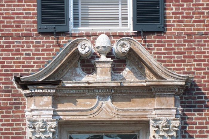

My latest project is ramping up to speed…I am repairing a mish mash of Architectural Details that need un-mish mash ing.
Here is a front entrance that was stripped and found to need a little massaging to ready it for new paint..
So far I have remade a little of teh base moulding, and have turned my gaze and moulding planes to the upper coner. These are odd profiles from 1900 and such short runs makes hunting down the stuff slower than just making it from scratch.
I luckily still had some 2″ Cypress left over from a job a few years back, it planes well, and matches what is there.
Normally, I see capitols like those leaves cast out of plaster, these suckers are carved wood…a few fiddly bits to glue on and recarve to match, but nothing serious (so far). I am trying to use as little filler as possible, so its glue on a block and whittle to match. All then gets resanded and primed and painted. I’ll be doing that part too it looks like.
Soon as I get this done there is another just like it on the other side of the house..
Oh, yeah, they get wrapped with copper on the tops and mid water table element. I’ll get close ups when I get deeper into them.
Fergot a pic.

Looks good. Cyprus is a good choice.
