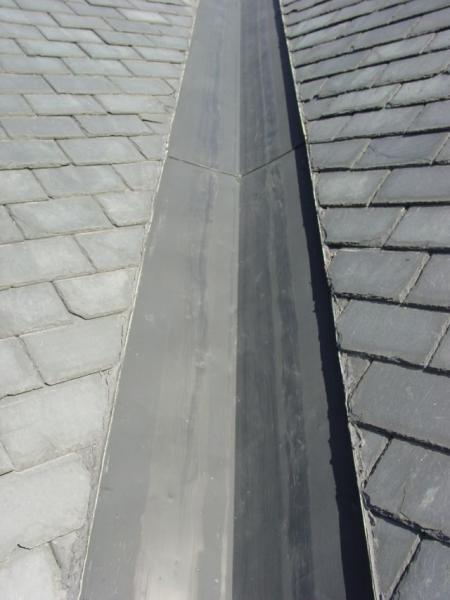

Here is a copper valley with a 3/4″ lip at the slate exposure line.
Must have been to keep the valley slates in alignment.
Guess whats happened to the bedroom ceiling?

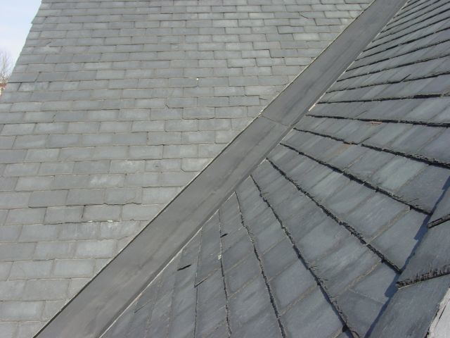

It was done many moons ago,but now has problems.I did a roof inspection today on this house, and pointed up a lot of issues to address.

Why is it leaking? Just currious because I dont see the problem thats obvious to guys like you and seeyou.
Doug,
The water can't flow freely over the slates and directly onto the valley sheet. It is dammed up slightly with that raised rib at the exposure line,causing water to flow down the inside of the rib too.
After time erosion corrosion has worn away the copper in behind and it leaks down low in the valley.
Outwardly it doesn't look bad, but having done several of this seldom seen technique over again, it will be part of my quote to fix up this house which is changing hands.

Thanks, I'd a never guessed that would cause the problem.
You know, it's a pity, because it sure does look purdy.
