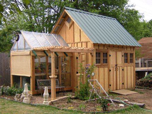

Copied this from one I saw on a magazine cover a couple years ago. Posted it in ‘over the fence’ a while back.
Note: The building sits on pressure treated timbers over a firmly tamped gravel footing 18″ deep with an interior floor of gravel 6″ deep. Saved a lot on using a conventional wood floor.Managed the entire set up for just under $1700.00. The glass on the greenhouse was from exterior doors that I reclaimed from one of my remodeling jobs.

What are the dimensions?
The shed is 10' x 12' and the greenhouse attached is 6' x 8'.

I gotta ask howcome 10' instead of 8 or 12?
A person with no sense of humor about themselves is fullashid
Good question. The best I can say is taking in factors like yard placement, set back issues and remaining garden space between the building and future deck and hot tub at the house and that it was the proportion that I felt gave bset balance to the greenhouse and roof lines. Believe me I built this a dozen different ways on my computer till I settled on these proportions..
