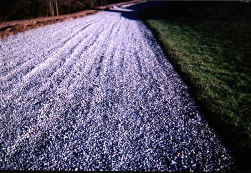

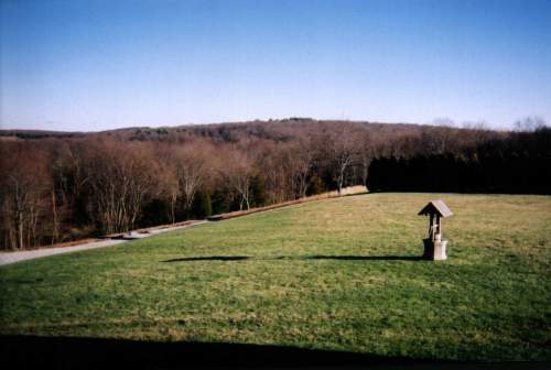

Well here they are...these were taken by an amature (yours truly) with a cheap camera >>>EDITED for file size<<<jump to 37974.13 for pics
Edited 12/21/2003 5:56:07 PM ET by bob
Hey it works!!! Amazing..........
These pics are all 'after' the grade improvement. I raised the lower level a couple feet to lessen the angle of incline...I SURE wish I took before pics. It would have been a good supplement to my post 37450.97.
BTW I have more pics...especially one(FEAR FACTOR) of the front lawn, but the contrast(?) is waaay too dark. If I post can someone 'fool' with it to improve the quality??????????
Edited 12/21/2003 11:55:37 AM ET by bob

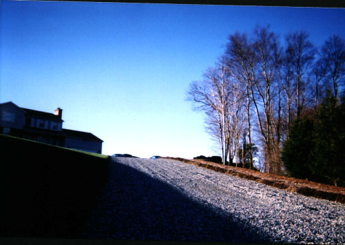

Bob, the only one that made a lot of sense was "driveway up". Doesn't look like you have any drainage plan. Could that be? What's the slope?PAHS Designer/Builder- Bury it!
Dialup.
56k.
And lots of patience.
Live, Love, Forgive and Forget
quittintime
VaTom...hello again
>> Bob, the only one that made a lot of sense was "driveway up". Doesn't look like you have any drainage plan. Could that be? What's the slope?<<
OK, so I flunked photography 101, 'LOL'... all I was trying to do was show the elevation difference and then I realized most, if not all of the photo's did not do this very well. But nonetheless, I posted anyway.
As far as drainage...temporarily, its crude, but effective. The hay bales along the driveway edge control the bank erosion along with the 4-6" of wood chips on the outer bank. The hay bales guide any excessive surface runoff to a culvert next to the street entrance. I've survived a quite a few torrential rain storms with no washouts. Also the drain tile on the driveway controls any washouts as well. This was my first attempt(no prior experience with driveway installation) at correcting a major disaster that the builder left. I'm surprised that a c/o was even issued considering that the original drive was only8- 9' wide and then a free fall/roll down to the bottom of the valley. I know that some drainage sys will be required before asphalt, just not sure what. All in all, the driveway is now SAFE and is STABLE. I had excellent results with the steep front yard(I planted grass) and was hoping maybe the same for the outer bank or use some type of ground cover. Correct me if I'm wrong, but the only other need for drainage is to protect the 'future asphalt' from any undermining washout, right??
Hmmm..Slope angle--I'll keep it short(if I can!) STILL don't know!! Sort of backburner'd the GPS. The Garmin 72(I now know) will give me a fairly close #, but what I've learned is, I really need (or want) the GPS with the baro sensor(altimeter). That one will satisfy my sense'less'bilities, I just need some extra time to master the GPS 72 first. I have 30 days to exchange the '72' for an enhanced model with the sensor. I may just settle for the protractor or storypole.
I sure hope to shake this newbie stigma, here at BT, but for every one step forward, I lose two...sometimes, anyway!!
Any interest in the other pics? Some could show the elevation difference better.

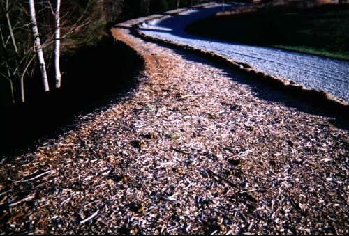

So here's a couple more Stayman's for all you coaching :)
(chuckle) This was my first driveway too, and like you, correcting the mess the "professional" left me. I've often wondered why there's no code here governing driveways. Would have saved me a lot of expense/grief. The county bureaucrats all claim to be overworked and underpaid anyway. But I was able to use my almost impassable driveway to drive my initial tax assessment down to bargain-basement levels, half of where the assessor started.
It's always good to see driveway solutions, both for slope and drainage. I eventually saw how to reroute my driveway to have half the slope I once had, eliminated 2 nasty turns, and end up with a shorter total distance. Go figure.... And it turned into a small side-line for me, driveway surveys. Now, if I could just get the machine operators to follow the stakes....
Youse guys and your GPS stuff..... I don't know. A straight 2x4 with a level and tape measure will give the slope %.
Those hay bales make a gutter for the hill runoff? Looked like the driveway went straight up the hill, so that wouldn't have been much of a problem anyway. What I thought I saw was a driveway that wouldn't shed water to the side(s). I've seen horrendous things here with water travelling down the road, carrying any available stone with it.
One guy wanted me, as a repair, to lay 100 tons on his drainage-challenged driveway without fixing the problems. When I suggested he needed to spend some money on machine time to fix the drainage, he acted like I was trying to cheat him. I told him to call the quarry and buy some stone, just get used to the idea as it'd be a commonplace event. Quarry trucks would have had an interesting time trying to spread. I didn't go back to see how it turned out. PAHS Designer/Builder- Bury it!
jeez...wish I thought of hammer'n the tax assessor, but too late now and wouldn't be worth the hassle in this understaffed/over budgeted town.
your post raised a few more questions, if you have time.
>are you referring to a 'crown' in the center of the driveway as far as shedding water to the sides? The lower stretch does have a slight pitch to prevent ponding, but I thought that the 'crown' would only be required when I paved it...and the asphalt crew would handle that. The slopes on the hi side already have established growth, therefore no concern for any rocks or debris to wash onto the driveway is present(at least so far) The original driveway used to wash out some serious ruts and canyons(on the slope part) but now the drain tile controls it quite well. The only trade off is teaching people how to DRIVE up the hill without spitting stone all over the place.....and its a 'PITA' to plow with a front loader!!
>the hay bales DO make a great gutter for the runoff, but I wonder if I should have curbing installed(on the outside of the driveway) with the asphalt....one time I removed about 20 of the bales near the street so a delivery of the mulch chips could be dumped. Before I could replace them, we got hammer'd with a downpour and the >gutter< carried the water just as I expected but took a detour at the opening in the >gutter< and what it left was a rut almost the size of the canals they have in Phoenix AZ(I've lived there). If I get good solid growth of grass on the outside bank(10' wide) will I have problems without curbing, just blacktop? The slope in the front yard(LH side of driveway up pic) was a challenge to grade, seed and grow, but now that it is established, it does not appear to have or cause any problems. But...I've heard that the gravitational pull will cause downward migration and since there is no permanent structure now, I may not even notice it. Will it become a issue with the asphalt? In its current state, with the makeshift gutter,....nothing has moved even with major downpours. So with all the storms(and sleepless nights worrying) I feel confident that no curb is needed. However it would be nice to get a little reassurance from someone who appears to have real experience with this type of situation.
