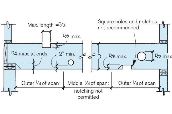

I have a new construction cabins in the San Bernardino Mtns. near Lake Arrowhead. Roof is two story (with loft). Sinks are on opposite house ends so apparently I have to run two separate vents. Anyway to avoid doing this? That being said, if I do have to run vents can the beams be notched out and covered with a plate instead of being drilled through?
  1. ktkcad | Feb 13, 2019 05:44pm | #1
    Rule of thumb: Do not notch beams - Corollary is: NEVER Notch Glulam or engineered Beams!. Google 'notching and drilling beams' to see what is appropriate and what isn't. Just remember its the top & bottom and either end of the beam that is doing the work and any interruption of those edges shrink the effective size of the beam.
