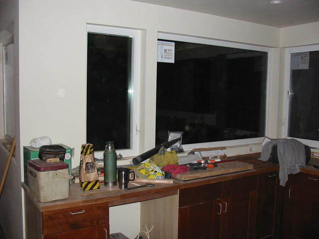

  3. ruffmike | Mar 06, 2008 02:49am | #5
    We put ours in coming up on 4 years ago. We are happy with it. We did not use their countertops. I also used their cabinets and wood countertops in my baths and everything is holding up good.
     If you do go with them, make sure the order is right. Takes forever to get replacement pieces. They go together easy, liked the upper cabinet muonting bar. Of course you get what you pay for, its not high end stuff.
     Just snapped some pics-
                                Mike
      hubcap | Mar 06, 2008 02:52am | #6
      thanks mike- they look prettyNo Tag

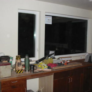

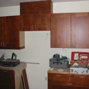

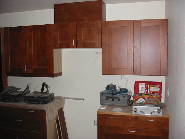

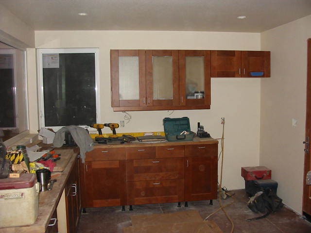

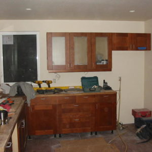

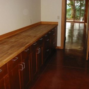

  6. dovetail97128 | Mar 06, 2008 04:58am | #17
    Lots of assembly time. I spent one entire 8 hr. day just assembling drawers.
    Fair sized kitchen , storage counter with base cabinets maybe 17', two baths.
    An appalling amount of cardboard and plastic packing material to deal with. Filled a full sized pick up and 4'x 7' trailer with flattened cardboard cartons for recycle.
    Careful of edges, easily chipped, I wouldn't use the plastic legs again , instead I would build a base.
    Triple check the order, many outlets have sales on "in stock" items and then don't restock that color/style etc.
    No better or worse then anybody else's inexpensive cabinets.
    Doors, drawers and drawer hardware are the best part of the order in terms of quality .

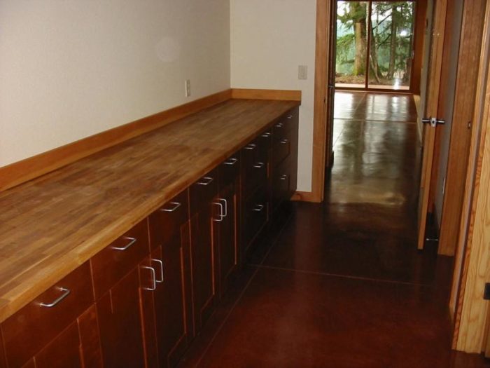

      hubcap | Mar 06, 2008 05:06am | #18
      More important now
      Who did your concrete floors- they look sweet and homeowner wants the same- I only have a couple of options here and would like to pick someones brain to get it rightNo Tag
      1. dovetail97128 | Mar 06, 2008 05:49am | #22
        A local flat work concrete contractor so unless you want to pay for travel for him and his crew I don't think his name is going to help you . Colored concrete, stamped concrete are his thing. No power troweling at all on that slab. I paid steep , but other then 2 pretty minor problems I was quite satisfied. Temperatures were in the high 80's the day of the pour with a wicked hot wind blowing . Finnish is a commercial floor floor finish , needs redoing every few years. That I can get the name of the product for you if you want.
          hubcap | Mar 06, 2008 06:07am | #25
          Oregon......................................................Ohio
          I bet I can find someone closer maybethanks for your inputNo Tag
          1. dovetail97128 | Mar 06, 2008 06:12am | #26
            ;-) yea that what I was thinking. Colored concrete and specialty concrete is big around here so it wasn't too hard for me to find my guy. Might check your local batch plants for leads.
