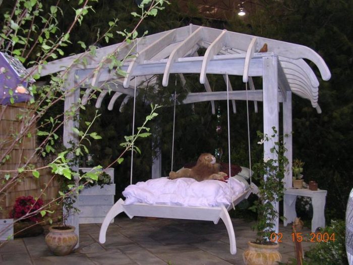

Trying my hand at posting a pic for the first time. Wanted to see how to do it. Be careful though, one of them is really big cause I didn’t know how small to make the pic. So one pic has been reduced and one has not. They are of the same pic.
Anyway, the pics below are of an arbor I designed and made for a local landscaper. He participates in a home and garden show and most years has my boss help out on the hardscaping stuff (the structures and buildings). Last year we made a 30 ft tall light house. Anyway, this year he asked for an arbor with some kind of a hipped roof line. He told me the idea was to put an outdoor bed underneath. That was the extent of my instruction.
I think it turned out pretty nice though I was not totally pleased with the bed. In fact, the hanging bed was an after thought at the last minute. They were panning just some ugly single bed frame on the ground which wasn’t really even nice enough to put at the local thrift shop. I had extra lumber so I suggested hanging the bed. They liked he idea as you can see. So I only had about an hour or so to make the bed cradle and I think the corner detail is not quite right (should have been on the hip angle and more rounded off at the top and bottom). I also instructed them to hang it with really PHAT rope but you can see they just used some thin stuff from HD.
Anyway, enjoy the pic. If you want to see other angles I have more pics too. I hope they post.

What did you make the arbor out of? 2x10 or similar? Are those legs on the corners of the bed? Looks like something you would see in a H&G show. And you're partially right, the rope is too small...they should have used a fatter rope.Whenever you are asked if you can do a job, tell'em "Certainly, I can!" Then get busy and find out how to do it. T. Roosevelt

The rafters are 2 x 6 I think (I can't really remember) and the hips then I'm sure are 2 x 8. I find that the scale of all members of an arbor to be probably the most important "feature" of a nice arbor. So I try very hard to select stock sizes that will be "appropriate". All was pressure treated stock. The rafter tails were cut from 2 x 8 or 2 x 10 stock and scabbed onto the ends of the rafters with biscuits, glue, and galvanized screws. I spent a lot of time deciding to do it that way instead of something more. But in the end, the client didn't want to pay for more..... of course. The pattern for the rafter tails was made in AutoCAD and printed full scale. Then I just traced it on some masonite stock and cut out a hard pattern.
The tails on the bed are not legs. That's what I mean when I say that they don't look quite right. They were intended to compliment the tails on the arbor but ended up too steep (they are set at the rafter angle). That's why I think if they had been set at the hip angle they would have looked better.
As for the rope..... the whole idea behind this arbor feature was a little bit of fairy tale type feel. And in that case, I think they probably could not have gotten a rope that was too fat.
Still, I think the client won a first place for their entire garden display.
Rob Kress

If this was for a show, why did you use PT lumber?Whenever you are asked if you can do a job, tell'em "Certainly, I can!" Then get busy and find out how to do it. T. Roosevelt

I used PT because the goal is always to sell everything at the end of the show. So the arbor I made last year sold the first day. Don't know if this one sold. In any case, we make them with a sale in mind. And along that same line, both arbors that I built could be taken apart and put back together. Although, this one would not be an easy job for just any do it yourselfer. We built the entire top section on milk crates on the shop floor. Then we lifted the entire assembly up onto the posts and apron with a fork lift.
