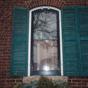

Homeowners recently said that the set of storm windows I built and installed on their brick Victorian have made their house noticably more comfortable. They say their furnace is running less. The storms made a bigger difference than they expected.
This is encouraging me to suggest repairing old windows and adding storms rather than replacing them.

    What is that reflective black colored sealent around the perimeter of the storm glass there?

      I used a black "lifetime" 100% silicone sealant on both sides of the glass. It is fairly glossey.The frames are 5/4 pine with weather stripping on the inside and plastic chair leg "feet" (little plastic disks w/ nail) to maintain a dry air space between the storm and sill.

        Seeing that looks like a single hung do they plan on removing the storms in summer?

          I think they plan to remove storms in spring, and put them back up in fall.They have a set of screens. I suspect that a few storms will stay in all year.The hardware on these storms also allows you to push out the bottom of the storm, for some ventilation, without taking them down (only a good idea if the bugs aren't bag).

      I had the good fortune of having old storms to copy. The bottoms of the old storms were rotten, even so, with some measurements, I had plenty to go on.I used a piece of string and a sharpie marker to determine the radius. I marked the center vertical line on the glass. Then I held one end of the string on the upper left corner of the storm frame and the other end of the string on the center line. Then I experimented with different radiuses until the length of string held on the center line scribed out an arch just like the old frame.I hope that made sense. My storms were made with an approx. radius of 16". I compared my radius with all of the old storms and the old brick arches. I cut the arches out of 5/4" x 6" clear pine stock. My first arch was cut with a jigsaw (I don't have a band saw) and fine tuned with a belt sander. This prototype was used as a pattern. I cut the other arches with a router and a pattern forming bit, making two passes to remove the full thickness. The frames were joined with pocket hole screws (galvanized) and titebond 3.

            what is the concrete looking "trim" around the window / seems like that should get painted out w/ the hardwarethe observation that those shutters are hung incorrectly
            is it not that we are all used to looking at faux shutters and these are hung correctly? think how they will look when they are closed

    Nice work, but for gods sake paint the clips so they dont show. BTW you should tell the home owner that their nice/real shutters are on backwards.
      basswood | Apr 26, 2005 05:33am | #13
      Thanks. I'm not the painter on this project. I usually just stick to carpentry.This time I built the frames, the HO primed and painted, the glass shop glazed 'em, I caulked, weatherstripped and installed. My part is done.
