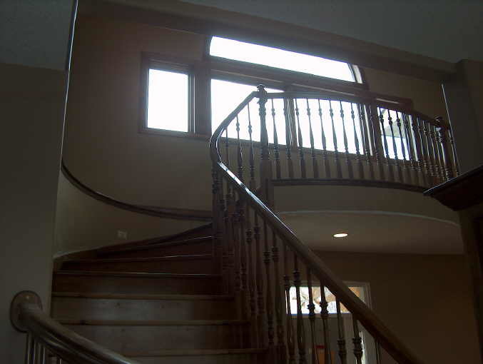

Took a few quick pics this morning of a nice home I’ve been working on off & on since Christmas.

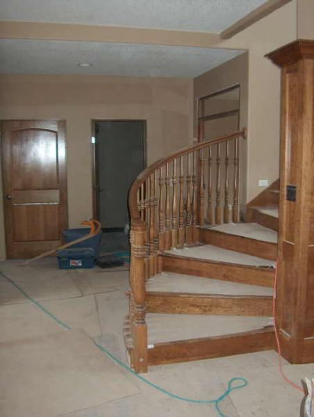

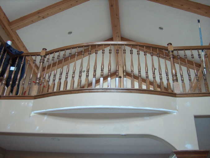

I did the glue-up & install of the curved cherry skirtboards & railings. (They were profiled by another guy). Stairs were built in place by the framers, quite accurately even. Made the glue up & install pretty easy. There are three of the curved balconies on the second floor. The basement stairs are underneath the upper stairs, should finish those railings up in the morning.

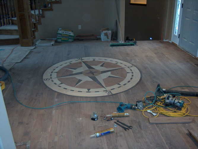

Also did the hardwood floor install, #1 Com 4″ Walnut & inlaid the compass medallion in the foyer. Tomorrow I’m going to cut in a border in the dining room made out of strips of ash & maria rosa.

Is the compass rose laid out to true north or magnetic north?
zak
"so it goes"
I was thinking the same thing "true or Magnetic". Most likely nautical in nature, so I would guess magnetic.__________________________

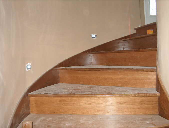

Are the skirt boards laminated or veneered? How about the risers?
Chuck, the skirts are laminated, five 1/8" plies. Glued up in place before the drywall went on, so I could use the studs to clamp to.
The risers were all straight, so solid stock was used for them.
Its magnetic north - HO tried using a GPS to set it, but it wouldn't work in the house. I'm guessing that would give true north?
Anyways, I set the template on the floor, handed him a pencil & had HIM put a mark where he wanted north.
