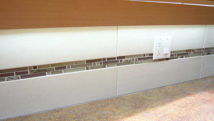

BTW we also use this system on kitchen counter backsplash situations. Silicone the gap between the countertop and the backsplash then set the tile in the Schluter. Schluter bottom siliconed to the counter. No gap - easy to clean up. The line you see in the picture on the bottom of the tile is the small groutline in the Schluter

Nice splash.
Any reason (other than cost) that the devices were not moved up into the white tile?

this is an example when the HO wants the job done as fast as possible but does not have full specs when the job is started. Materials are selected on the fly. Originally this was supposed to be an all-glass strip backsplash. Then he saw this decorstrip at the tilestore. He did not want to spend any more $ after we had to repair the whole wall. The original apartment framing was 3" out of square on 13' length. Ze Fraimers should have been sent to ze Konzentrationslager - jawoll
