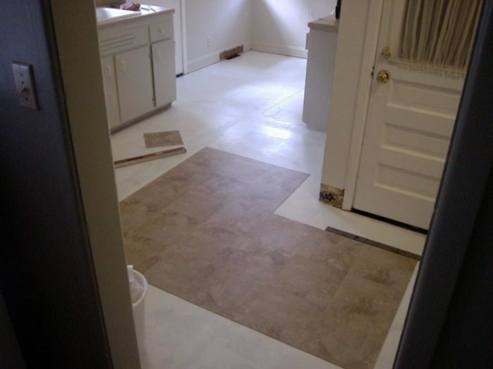

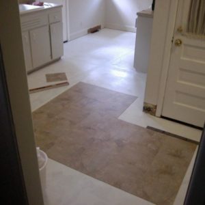

  7. mrfixitusa | May 23, 2008 06:17pm | #9
    when I did my kitchen floor a year ago I put down a layer of luan, then I patched all seams with durabond if I remember correctly and then I put on a coat of paint primer on the luan
    When I installed the peel and stick tile I had to be careful because the glue was so sticky
    When you lay a piece of tile the glue is so sticky it's hard to adjust it or move it slightly, even those first few seconds
    I did not go over the tile with a roller
    It's held up really well - we spill a lot of water on the floor etc as it is in the kitchen
    Good luck
    Spring Break = Summer Broke

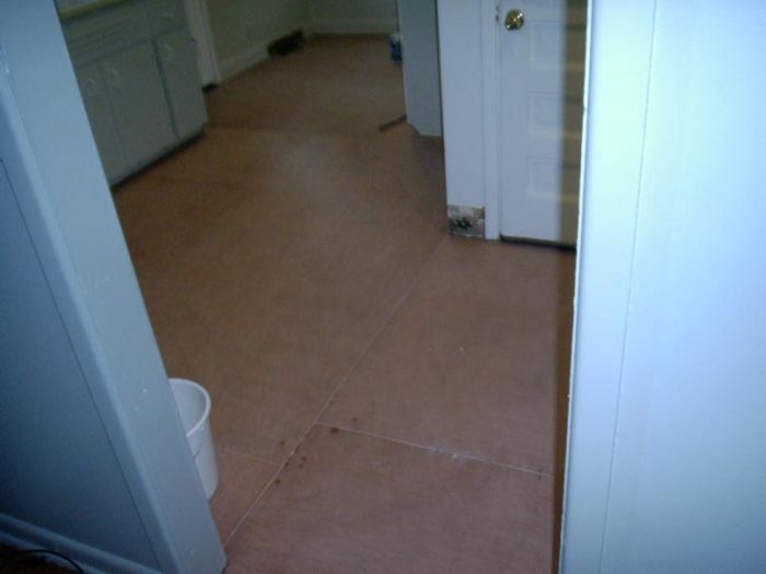

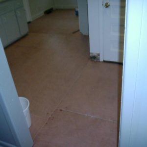

        Well, I got to thinkin'.
        Removed the old linoleum on that kitchen floor today in prep to lay some luan.
        This has got to be one of the funkiest floors to deal with. Somewhere along the history of the place the bath and kitchen area was reno'd and what they did was
        placed 2x6s perpendicular to the old 2x8s of the original floor joists
        only the original floor joists had 7/8" thick 1x12s/1x16s on the joists and 1x4 tongue and groove on top of that.
        Then the new 2x6s were placed on these little 8" stilts made from  3/4" t&g and nailed to the sides of the 2x6s lifting the joists 2 1/2" off the 1 3/4" thick original flooring. These were placed about 7 to 8 foot apart on each joist.
        Needless to say there are many squeaks and movement when walking on the 9foot wide floor.
        Even with luan going down before the Armstrong self-adhesived foot square vinyl tile is there possibility of the movement messing with the longterm adhesive properties or am I overthinking this too much.
        I was tempted to trade in the vinyl squares for some rolled vinyl instead.
        And one more, what should be used to secure the luan?
          IMERC | May 29, 2008 04:17am | #19
          that much movement...
          go with the sheet goods....
          luan....
          is it for underlayment as prescibed by the manufacturer????
          or the economy junk????
          trowel one of the mastics down such as the type rated for paneling or FRP....
          set the luan and staple the snot out of it...

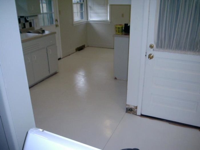

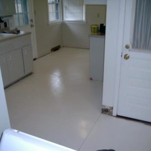

          9. rez | Jun 22, 2008 07:40pm | #30
            Talked the ol' boy into a vinyl sheet and it is the cats meow.
