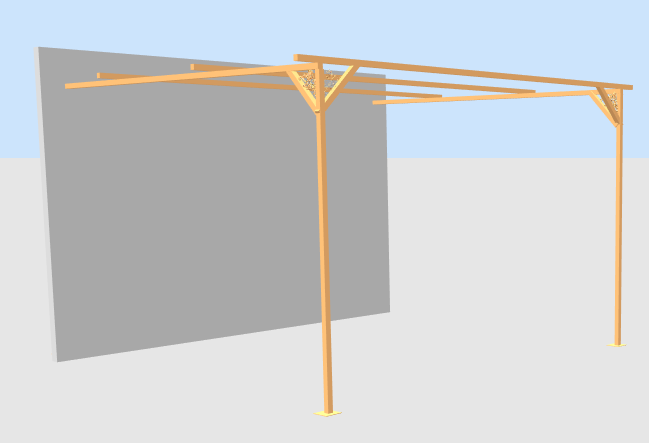

Hello guys, I’m building this structure over a deck and I was wondering what suggestions you might have about attaching it to the exterior wall. These are 1.5 inch square metal tubes. Thank you.

Sun shade?
Rain shelter?
or more?
Climate?
Dimensions?
Hope it's not a roof in snow country.
The only things would be added are curtains on the sides. No roof.
Dimensions are 11x11 and 7 in height.
Thank you.
Siding on the house?
Yes, House have siding.
What kind of siding?
Vinyl.
You will need a solid blocking devoid of your vinyl to fasten it to the house. Might as well build it as if you were to add covering later…….
And of course you’ll want to properly flash the siding and finished cover at the blocking.
You should consider wind as someone some day may decide to tie off the curtains, when their beer gets knocked off the table, effectively making a sail.
I’ve seen weight drop curtains do more than knock of the beer…..get one of those on the side of the head……
Geographic location would help to add better insight.

Yeah, let's attach them thru the vinyl siding and squeeze it flat against the sheathing.
