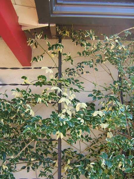

    Our trellises are full height so I attached them to the rafter tails at the top and wired them to stakes at the bottom.  Of course, this is California and we don't do soffits, which makes it easier.  If you look closely you can see the angle bracket and bolt in the picture.  (Variegated Bower Vine - Pandorea jasmonides; the trellis is an old fence - looks much better verticle than horizontal!)
