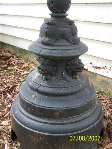

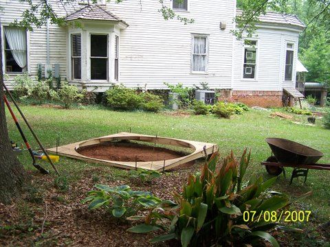

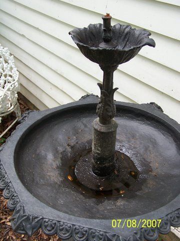

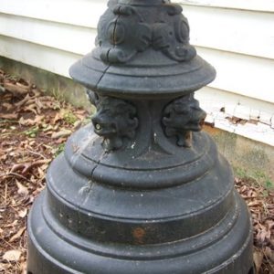

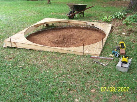

Playing with this today at home.  Great Aunt’s old French fountain.  Pouring a 93″ OD X 77″ ID X 5-11″ deep level ring; liner sheet goes inside that on a sand bed; fountain on riser so its base is just at the water line.  Liner laps over the 8″ wide top of the concrete ring; dry-laid old brick from Great-Great uncle’s brick factory in Asheville laid around the concrete ring to anchor the liner sheet.
Fountain – partially disassembled – needs re-plumbing – it has HAND CUT screws!
Yes, it’s laser flat!  3/16″ Masonite wraps the ID down to the dirt, then the inner form goes in
