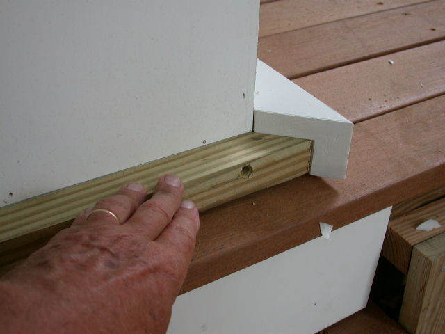

    If at all posible, I would assemble a 3-sided column away from you 6x6 post. Make it on horses, or a table, or someplace convenient. Then you only have to worry about aligning 1 side piece when you install the PVC column.
    And make the PVC column a bit bigger (inside)  than the PT post. That way, when the PT moves, it won't crack the PVC.

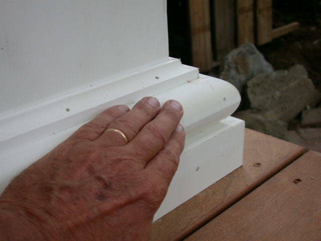

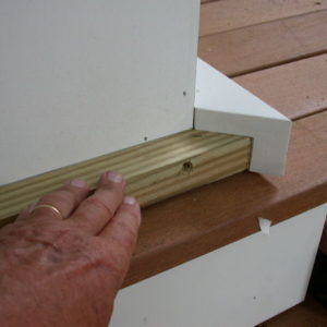

    1. MikeSmith | Sep 23, 2005 06:22am | #3
      here's some wrapped postsMike Smith Rhode Island : Design / Build / Repair / Restore

      2. butch | Sep 23, 2005 01:11pm | #6
        Mike that is an awesome looking front porch.The details look great.
        1. MikeSmith | Sep 23, 2005 02:32pm | #7
          thanks , butch.. we just muddle along from day to day to dayMike Smith Rhode Island : Design / Build / Repair / Restore

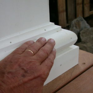

        That really is a great looking porch. Did you mill all the various moldings from Azek stock?********************************************************
        "It is what we learn after we think we know it all, that counts."
        John Wooden 1910-
        1. MikeSmith | Sep 25, 2005 09:19pm | #23

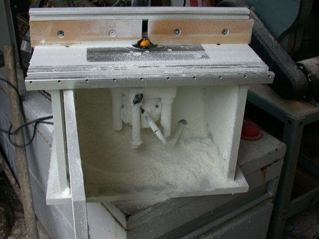

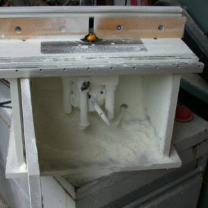

          yes.. some was built up some routed on a benchdog

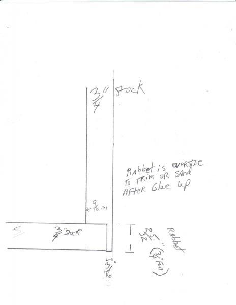

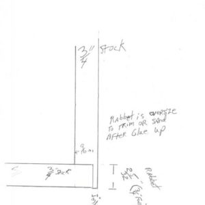

            Mike, only worked with Atez a couple of times. The stuff is so flexible I would think using a miterlock bit would be tough.I use this method for column wraps whether solid wood or man made boards. I rabbet the front and back boards so 3/16" is left. When the side pieces go in you only see 3/16". The rabbet is 1/16" wider than the boards, the 1/32" on each side is cleaned up after gluing by either sanding,hand plane or router with a bearing bit. The cleanup method depends on the stock being used. I think this would work on Atez too.
            mike
          7. MikeSmith | Sep 29, 2005 03:28am | #31
            i think matt said he had used  a lock miter successfully..
             can you do a dwg of your rabbet method ?Mike Smith Rhode Island : Design / Build / Repair / Restore
          8. mike4244 | Sep 30, 2005 03:37am | #33
            Here's the drawing Mike, pretty simple. The 3/16" lip when glued to the full board appears to be a solid post, even when using hardwood or manmade boards. The rabbet is slightly (1/32") wider to accomadate sanding or trimming after glue up.
            mike
          9. MikeSmith | Sep 30, 2005 04:01am | #34
            great .. what was dark is suddenly light..
             thanksMike Smith Rhode Island : Design / Build / Repair / Restore

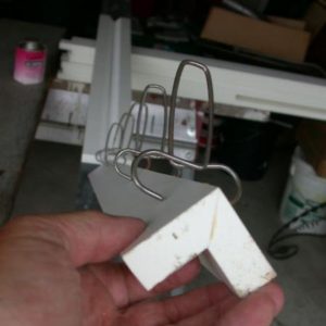

  7. fingers | Sep 29, 2005 12:58am | #26

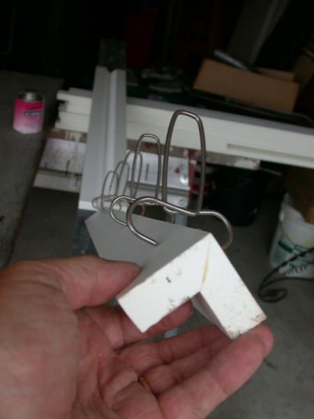

    I've messed with Azek corners alot and second what everyone here has said.  Use the Azek glue.  If you're set on mitered corners, I'd be sure to use some kind of holding jig because the glue can make the joints creep and ruin your accuracy.
    The other thing I've used is pocket screws, but you could only make a three sided column with all of them hidden and the fourth side would have to show some fastener, unless the fourth side was just glued and clamped.
