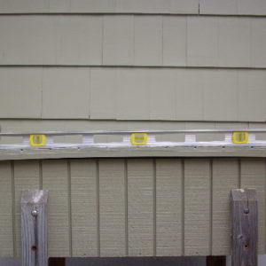

No great newsworthy info here, but I thought it was interesting to see the results of not considering expansion/contraction when using Azek.
This is a garden cart that I built from T-111.  The lid is also T-111, but I wanted to add a little rigidity by doubling up around the perimeter.  I had some Azek (It could be Koma, but it’s all the same stuff) lying around so I used that.
I didn’t really consider the expansion/contraction issue, nor do I really care, but here you can see the lid has taken a curve due to contraction in the current cold temperature.  When the weather warms up, it lies flat again.
As I said, it doesn’t bother me a bit, but it does serve as a reminder (at least to me) to always consider expansion/contraction when using PVC trim.

    there have been a few stories here of full lengths splitting when it is installed in the heat of summer, then shrinking 1/2" in length when it gets below zero.

    I think its a classic case of BOTH changng. The 'Tijuana elebben' may have got fatter as the azek shunk?
    Early humidty measuring devices were 2 thin strips of wood, one cross grain to the other and glued. As the hum. rose the crossgrain swelled and made a straight stick..when it fell, it would shrink and curl the longgrain sliver along with it. I forget the name and inventor ( DaVinci? maybe).
    1. DonCanDo | Jan 03, 2009 05:45am | #5
      That's possible, but the humidity tends to be lower in winter so the T-111 should be smaller too.
      Then again, is humidity really lower in winter?  Indoor relative humidity is lower, but I never really thought about the relative humidity outside.  The amount of moisture in the air is less, but it's ability to hold moisture is less too,  so that probably means that the exterior relative humidity remains similar all year long.  And what does that tell us about wood shrinkage?

        What about the joint surfaces between the two? Completely water tite?Spheramid Enterprises Architectural Woodworks
        1. DonCanDo | Jan 03, 2009 03:55pm | #8
          No.  They are simply screwed together.  What difference would that make?
            Sphere | Jan 03, 2009 04:06pm | #9
            The underside of the t-111 is wetter than the top and swelled, the azek has not. Any laminating of dissimalar materials , when one moves hydroscopically and one don't creates funny movements.
            Plus T-111 is the most warpy damm stuff I have ever seen..the old Fir wasn't as bad as the SYP we mostly see today.Spheramid Enterprises Architectural Woodworks

    I'm with sphere i don't think it's the azek as much as the t-111 pulling the azek
    1. DonCanDo | Jan 05, 2009 03:29pm | #16
      It may well be a combination.
      As an experiment, I cut a piece of wood and a piece of Azek to exactly the same length (about 3') in my 65° basement.  Then I place them both outside where it was about 35°.  After a few hours, I compared them to each other.  The Azek was just about 1/16" shorter.
      Allowing them to both warm up in the house results in them both becoming the same length again.
      So, Azek shrinkage is real.  I don't know how much this expansion/contraction can be resisted when PVC trim is secured in place, but it's still something that needs to be considered.

        I think some of us are getting confused. The expansion/contraction is due to temperature not moisture.
        We've been working with wood and it's moisture issues for so long that we are thinking plastic acts like wood ;^)
          Sphere | Jan 05, 2009 06:05pm | #19
          Yeah but if the 1-11 is wet and swelled, and atached to something that doesn't swell, you get a bow. Add the cold shrink to the Azek and it compounds the issue.Spheramid Enterprises Architectural Woodworks
            popawheelie | Jan 05, 2009 06:15pm | #20
            I agree! The t-111 is picking up moisture from below or loosing it on top.
            Some of the posts seemd to be saying moisture was swelling the aztec.
            I think I've heard of some plastics picking up moisture and swelling.
