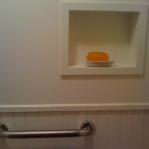

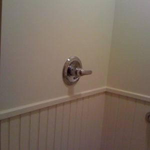

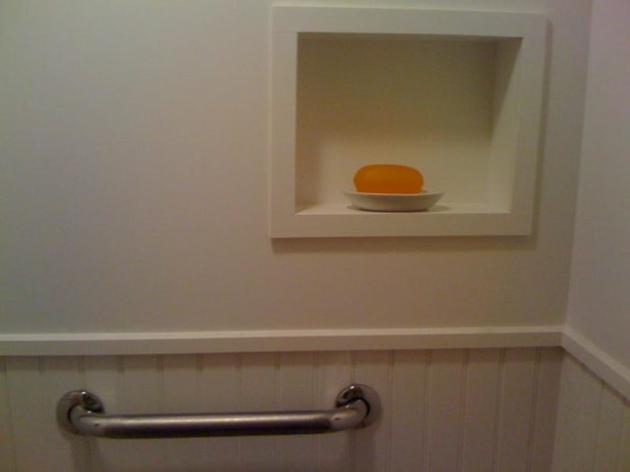

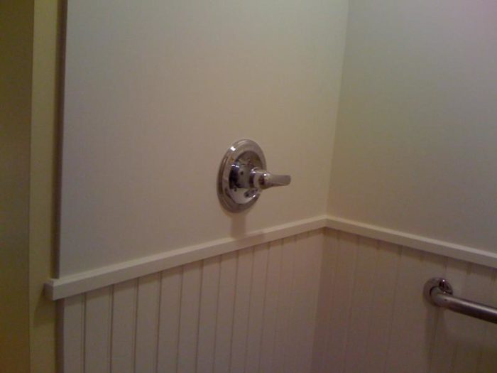

Good client let me Have My Way with her basement bath. Swanstone pan 48×32. Azek beadboard wainscoat style lower, sheet goods upper and ceiling. Waterproof and holding up, looks new, 2 yrs. later.

What did you attach it to the wall with?

The lower section (bead board) at that time it only came in 1/2x6x18, I adhered to greenbd with PL adhesive and 18 gauge SS brads, Any face nailing the hole was filled with white crayola crayon. Upper section and ceiling the same method was used. Recesses were Azek glued, siliconed on the back side. They were filled with water and left overnite in my garage. Not a drop leaked.
