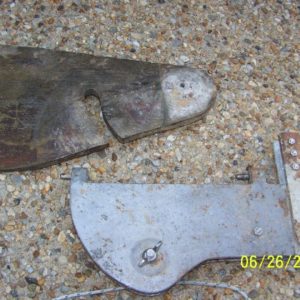

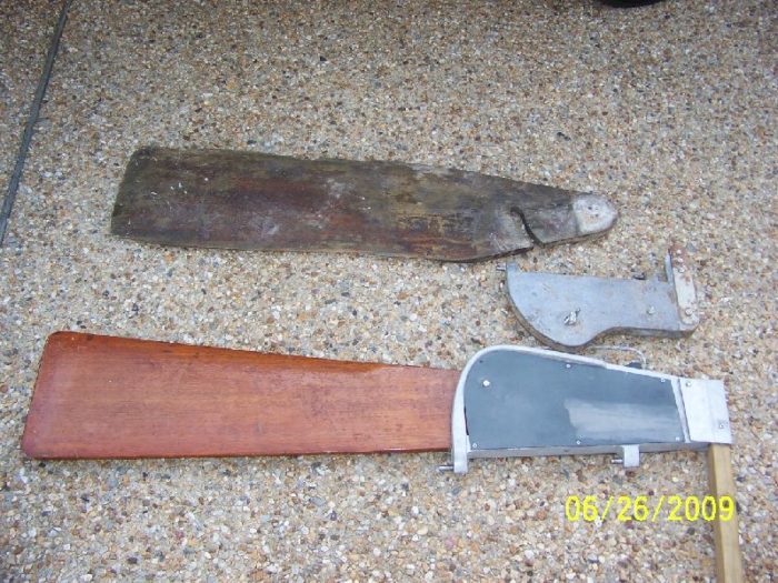

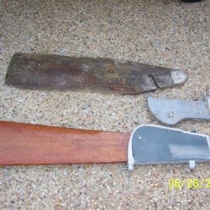

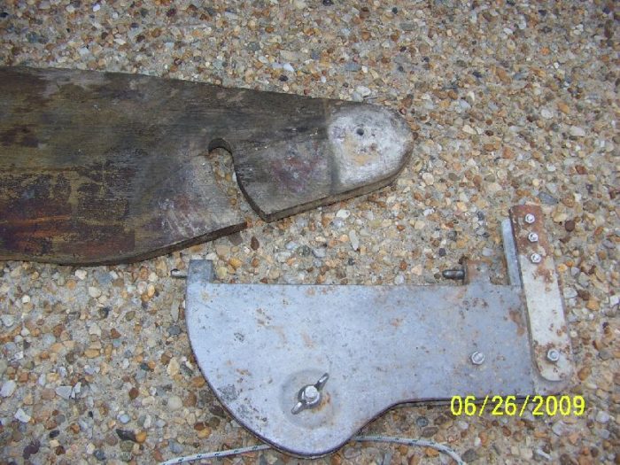

      When i picked up the boat from the seller, there was a almost new rudder on the transom, nice varnished plywood rudder with a piece of 2x2 pt pine for the tiller extension.  When we went for the pre-sale test float, I noticed that the top of the tiller was several inches above the transom and interfered with the ropes that hold the boom thing ... whatever it's called.  As we're loading up the boat to drive away, he hand me what looks like the original rudder and metal bracket.  The rudder is in pretty bad shape, especially the part under water, but the metal is still very good.  .  I compared the two metal parts, and found that the new one is about 6 inches too tall, hence the problem with the ropes.
      The new one has a rope devices that raises and lowers the rudder and locks it into place.  the old one has a slot in the rudder that clears a bolts with a large wing nut, I guess friction keeps the rudder down.  The old rudder is good ebnough to use for a pattern to make a new one, but I hesitate to modify the new one to fit the old bracket .. it works so why take a chance on screwing it up?  So i think I will make a new rudder for the old bracket.  Thought if I used sheet pvc I wouldn't have to worry about sealing the wood.

            That doesn't look too bad from the pic.
            That second rudder looks alot like a pic of a rudder off of a '76 16 that came up when I googled your boat.  Maybe they changed the mounting later also.
            With a new boat I think I'd just go ahead and sand down the old rudder back to good wood and hit it with two coats of West systems epoxy.
            'Specially this time of year. It'll get you through the first summer, this winter you will have a lot better feel for what the boat needs.
            I'm thinkin' there was a shock cord or something that assisted the rudder to stay in the down position...
            FWIW - is there a positive mount for the rudder to the boat? If not, you may want to put a "leash" on the rudder - alot of them don't float...
            The holders have a tension "clip" that holds them in - until the boat goes over - bye bye rudder...Remodeling Contractor just on the other side of the Glass City
