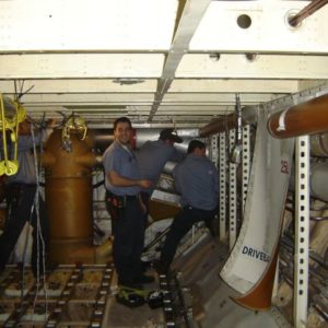

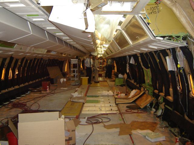

These would be a B767-300 going through a reconfigure of the entire cabin for the “new look”
The first and second pics are of the Fwd cargo area with the ceiling and sidewalls removed to access the wires for the new seats and entertainment systems.
The last one is of the cabin taken fron the rear of the aircraft looking Fwd.
The aircraft came in just before X-mas and is schedualed to go out on the 31 Jan.

    In pic 1, what are the curtains rolled up on the right side, and what is the fiberglass tank in the back left?
    Whu is there a ceiling?  Does it serve any purpose?  Seems like it add weight.
    1. TomW | Jan 12, 2007 04:23am | #2
      the rolled up curtains are the sidewall panels. They are made of a thin fiberglass material. The ceiling panels are made of the same tpe of material and are necessary for fire protection. Keeps the compartments seperate from the cabin. the big tank is the air conditioning plenum.
      1. john7g | Jan 12, 2007 06:55am | #4
        >...for fire protection. <
        as well as a secondary function of keeping the cargo loaders from fiddling with stuff they shouldn't be fiddling with such as flight control cables...
        1. TomW | Jan 12, 2007 07:15am | #5
          Yeah, that's a pretty good reason as well.
