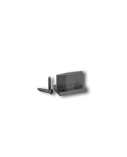

    C guide or stay roller.
    https://www.realslidinghardware.com/shop-hardware/
    1. qualityjob | Feb 03, 2020 07:50am | #2
      Those work but are visible systems, the system I remember was invisible yet the door didn't flop. I looked in the places I go for better hardware like Hafele and didn't find anything available OTC.
      1. calvin | Feb 03, 2020 08:20am | #3
        Would require a groove in bottom of traveler.
        Edit: it would have to be placed on the floor within the groove behind the fixed panel. Still under the traveler when closed and would help guide the door behind the fixed panel when opening......
