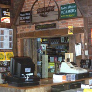

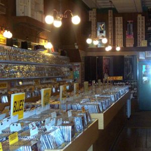

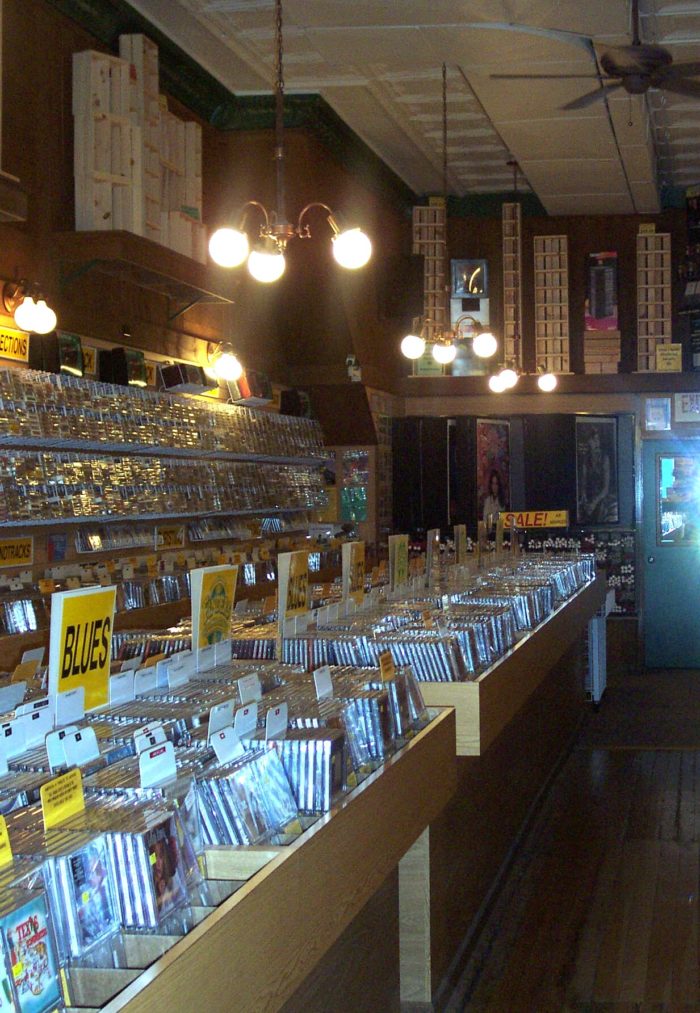

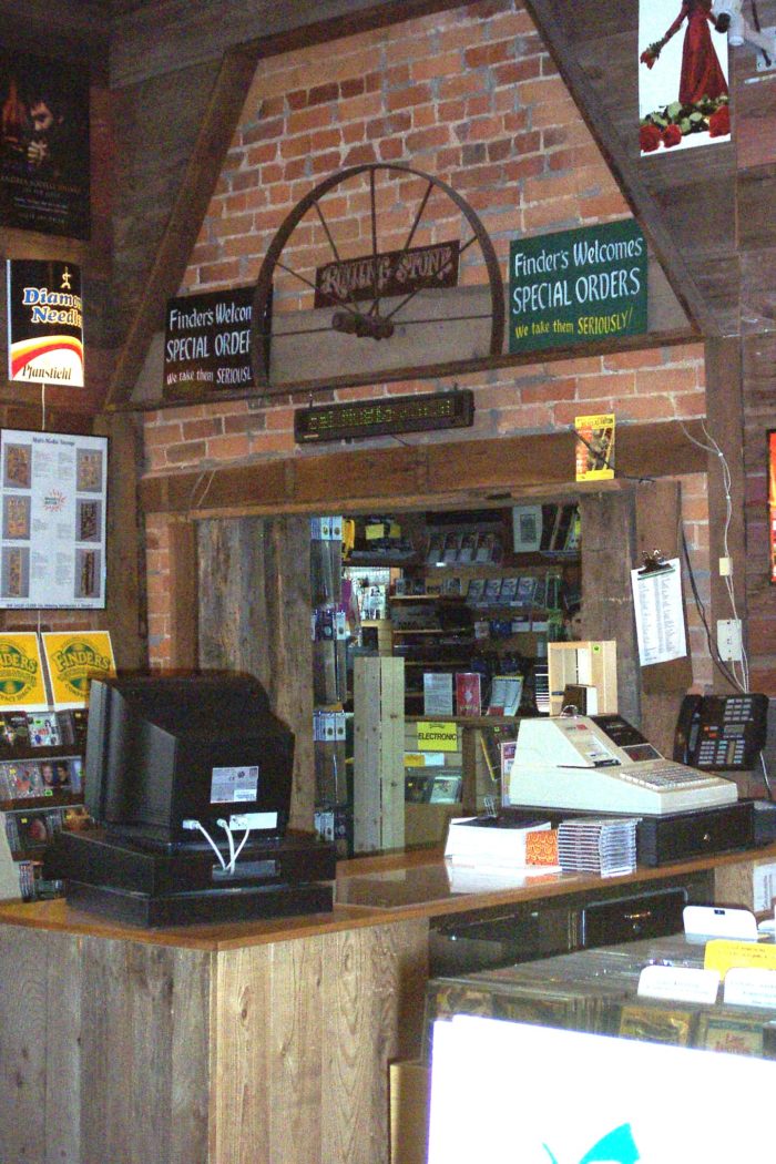

        Mick-rough sawn might give you the edge.
        The first pic-real mckoy, done in maybe '73
        Second, rough pine-done in '96 maybe.
        Sorry for the quality of shot.
        1. mick182 | Aug 03, 2010 10:47pm | #9
          Nice. I like the brick and carriage wheel incorporated in with the wood in the barnroom.

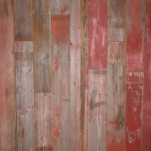

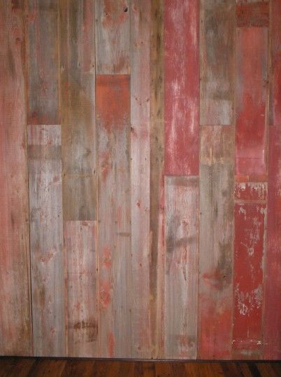

        2. mick182 | Aug 03, 2010 11:59pm | #10
          This picture is what i really
          This picture is what I really would like to do, but I have no idea how to achieve the look of these boards.
          Any thoughts on how to acheive a similar look would be great.

            Nope, other than experiment.  The look of 100 yrs of weather and paint either takes a hundred yrs or some facsimilie thereof.  The wood you like is real.  Making faux is time consuming if you get lucky at all.  Me, I'd find old and buy it or disassemble.
          2. DanH | Aug 04, 2010 08:19am | #13
            That look may actually be a little easier to achieve.  First off, visit some yards and see if you can find lumber that's been sitting there for awhile -- out in the weather would be ideal.  Figure out some sort of "tea" stain -- regular tea is too expensive and fussy, of course, but brown latex paint thinned way down might work.  Douse the boards with the stain, shake them off but do not wipe, then stack them, some stickered, some back-to back.  Using some rusty iron for some of the stickers might add some "interest".  A few boards you paint with something resembling the paint in that picture, then wipe irregularly -- similar to standard "faux" technique.
            Some place along the way use chain, bag of bolts, etc to physically distress things a bit -- you don't need that much for this style.  (A few nail holes made before the color treatment will help too.)
            Or, for this look, find an old wood floor being torn up.
